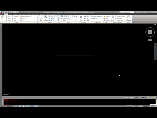

Centre Line between two Polylines
Hai here i have attached my dwg fortesting.....Actuall i am selecting two means its automatically need to take center point and offset that line..........[ATTACH]23380[/ATTACH]
Works fine on my end. What exactly is it doing? Copy everything that is returned to the command line and paste it here.
eg.
Command: lbl
Select first open curve:
Select next open curve:
Specify line to draw: [Lwpolyline/Polyline] <Lwpolyline>:

Hi, I just opened your drawing and tested the routine. It seems to be working fine to me. Here is a screen capture of what I am doing:
In case it is blurry, I entered LBL on the command line, then selected the top line, then the bottom line. After that I did a regen on the screen. Is this somehow not doing what you expect?
So, does this give you what you were wanting?
Yeah, its exactly what I was after. It seemed to me that balajibth84 was having problems with the routine. My little video was just showing it working.
You're welcome.
