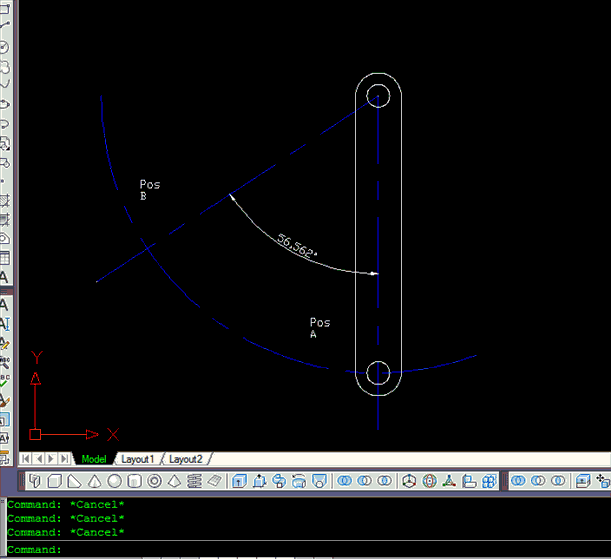

I have attached a simple dxf drawing
What I need to do is copy rotate the link bar from pos A to pos B and the hole must align with the intersection of the two centre lines.

Try using copy and reference options as such:
You don't even need to know the angle.
KC
