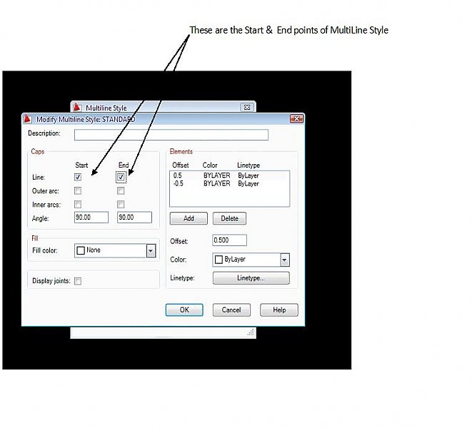

I meant the Start and End points that are included within Mline Style as shown in the following image.
Thanks & Regards

Ok, I see what you mean now. I do not use mline, So I was unsure. You can check the link alanjt provided. Entmake is a better way to go.
I took a look at mlstyle. If you save a custom mlstyle to acad.mln with your desired settings all you need to do is call it up with cmlstyle variable. This of course is one way if you do not decide to go with entmake. As I have shown you in post 2, These seem to be the only settings you can change on the fly.
