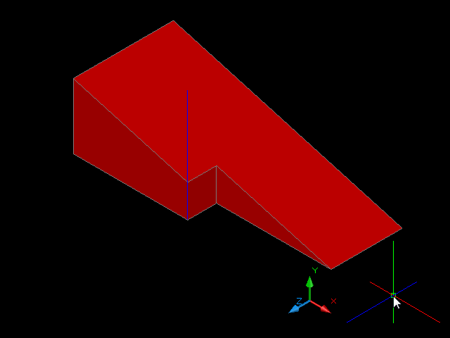

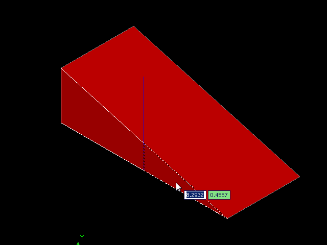

Yes. Imprint the line onto your wedge. Hold the (Ctrl) key when selecting the imprinted line and move along an axis as such:

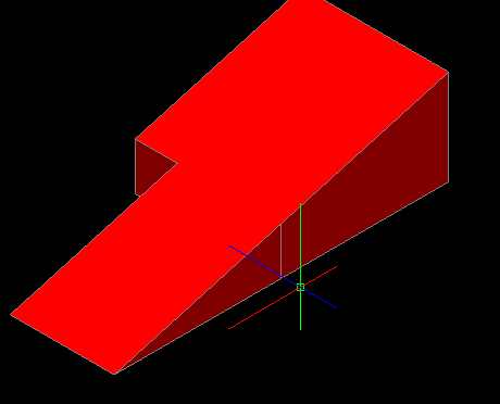

I think you might want to solidedit rotate a face.
Extrude the wedge and extrude the non-regular base shape then do an interference of the two solids
