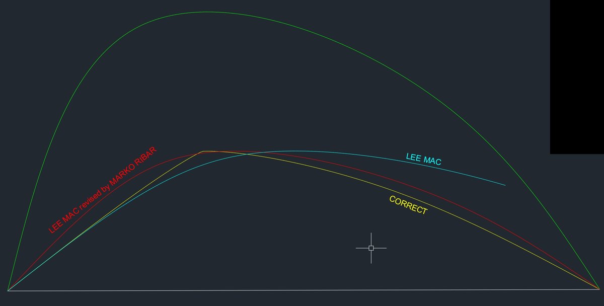

This is old topic, still I've run into this and I wanted to correct the code by Lee Mac...
This :
       (setq foo
         (if (< (distance (vlax-curve-getStartPoint e1) (vlax-curve-getStartPoint e2))
                (distance (vlax-curve-getStartPoint e1) (vlax-curve-getEndPoint   e2)))
           (lambda ( x ) (x))
           (lambda ( x ) (- l2 x))
When you analyze closer all input things should be :
       (setq foo
           (lambda ( x ) (* x (/ l2 len)))
           (lambda ( x ) (- l2 (* x (/ l2 len))))
Else as I see is fine...
M.R.

Hi,
Here is another version of the rolling ball by the bisection method. Part of the code is from Lee-Mac, thank you.
The code does not work for any curves and in the case presented in jpg you must first select the upper curve then the lower one (line).
