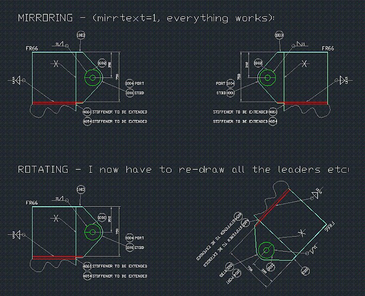

Hi,
I have recently been mirroring and rotating parts of drawings with lots of leaders on them. Using MIRRTEXT=0 I have managed to get around re-leadering everything when mirroring. However, I cannot find a similar variable for rotations, ie. A way to keep text the horizontal when rotating by 90, 180 etc.

hmm, unless i'm doing something wrong using your lisp doesn't change things much. My text is still skewed and I have to re-draw the leaders after rotating. I'm sure there's some way to keep text horizontal, but I just can't remember what it is.
here's a pictorial representation of my issues:

The drawings have come in to us already created, not with annotative text
we are having to add to them and reproduce what has been done at a different angle and mirrored, we have the mirrtext option set at 0 but the angle of the text is incorrect
