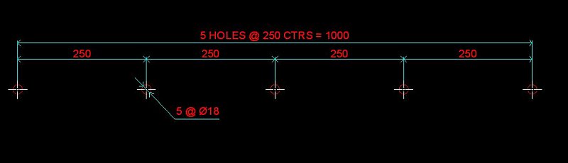

vinod Posted September 3, 2008 Posted September 3, 2008 Here I am attaching Screenshot of dimensioning. Please advise which one is standard for showing repeated dimensions? Quote
fuccaro Posted September 3, 2008 Posted September 3, 2008 Here we use the first way. But you should open a book to see your local standards. Quote
nocturne00 Posted September 3, 2008 Posted September 3, 2008 Im not sure on standards coz honestly there a several ways.ive only seen these ways on some textbooks 1. you can just dimension one bay with 2800 TYP. or 2. Place an Overall Dimension 11200, and dimension the indivudual bays with text EQL. or you could combine both ^_^ well this is IMhO anyway. check out what the rest would say Quote
ReMark Posted September 3, 2008 Posted September 3, 2008 I'd go with option 2 as stated by nocturne00 above. Quote
Enigma Posted September 3, 2008 Posted September 3, 2008 I would do it similar to your option 1, but the dimension would read more like "4 Bays @ 2800=11200" Quote

rkent Posted September 4, 2008 Posted September 4, 2008 Here I am attaching Screenshot of dimensioning.Please advise which one is standard for showing repeated dimensions? above dim line 11,200 below dim line 5 holes spaced evenly You are diminsioning the location of 5 holes not 4 spaces. MHO Quote
stevsmith Posted September 9, 2008 Posted September 9, 2008 I would tend to do it this way, saves any confusion. Quote
vinod Posted September 10, 2008 Author Posted September 10, 2008 I would tend to do it this way, saves any confusion. Five numbers holes mensioned at 2 places. Is it required ? If you put 250 in all bay, that "5 holes@250 ctrs=100" is not required. Am I right ? Quote
nocturne00 Posted September 10, 2008 Posted September 10, 2008 I would tend to do it this way, saves any confusion. Dimensioning like that would be a bit too redundant dont you think? Quote
dbroada Posted September 10, 2008 Posted September 10, 2008 I tend to use something like - 4 equal 250,0 pitches = which leaves AutoCAD to fill in the overall dimension (in this case 1000) Quote
