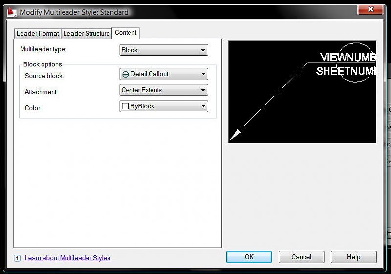

Try the Multileader style manager. You can design your own there.
When you click the Content tab, select block as the multileader type.
It will give you a couple of choices, complete with notation attributes you can edit upon insertion, or you can go into the block editor and build your own call-out shape that can be attached via the User Block choice on the source block drop down list. See picture.
Try creating a Multileader Style with the Content Type = Block > Circle

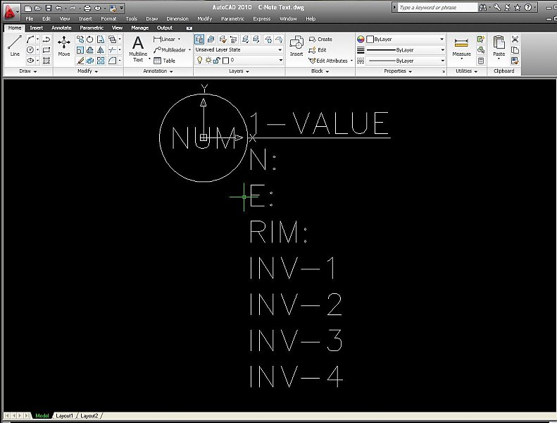

ok so here is the block...
this is how I want it to look with a multileader. everything comes in fine, now I just need to know how to get the first value underlined... it does it in the block but not when I insert the multileader.

have you tried to enter "%%U" prior to the text that you want to be underlined?
yes... and it works in the block, but when I insert it as a multileader it does not have an underline, nor will it let me type in %%u in the field and make it work... it just shows up %%UMH#1
