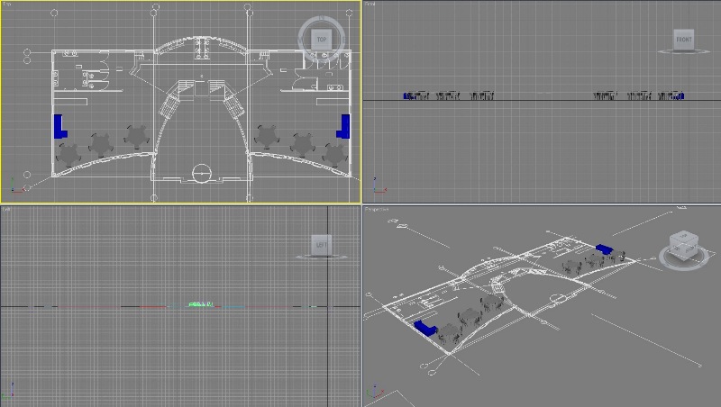

cvc009 Posted June 16, 2010 Posted June 16, 2010 Ofcourse its easy to import a dwg into 3DS MAX, but I seem to do something wrong of be forgetting something. My problem is that in 3DS the walls and other drawings are only lines, not 3d like in autocad architecture. How should I import or export it to have the walls, windows, etc. in 3D? Thanks alot, a quick answer would be wonderfull because tomorrow I kinda have a presentation for which I need this. Quote

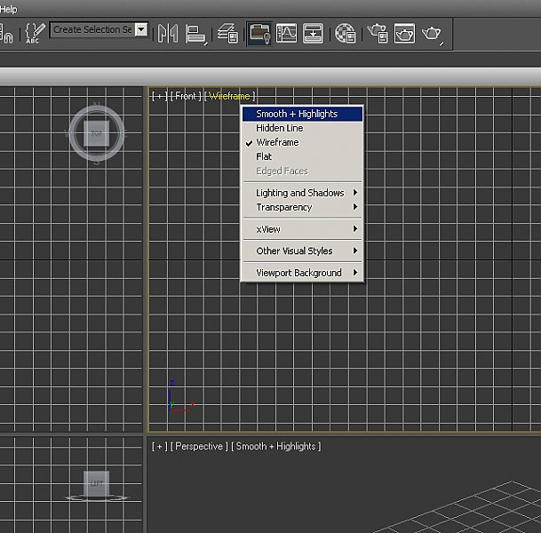

Cad64 Posted June 16, 2010 Posted June 16, 2010 The reason you only see lines is because you are viewing the model in Wireframe display mode. In the upper left corner of your viewport, right click on the word "Wireframe" and then choose "Smooth & Highlights" as shown below. Quote
cvc009 Posted June 16, 2010 Author Posted June 16, 2010 thanks, this helpes indeed with the 3d objects in the dwg file, but it still doesn't show the walls, windows, etc. made in autocad architecture, these stay lines only. They stay 2d (only really visable from top), i hope i can get these in 3d. Quote

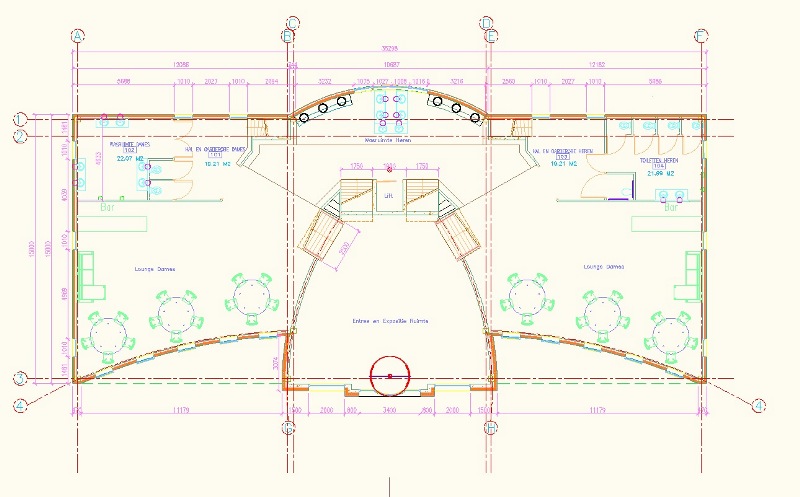

cvc009 Posted June 16, 2010 Author Posted June 16, 2010 I hope the screenshots make it clearer indeed. In autocad architecture you draw in 2d but with the info inserted it is actually 3D, right? In ACA I can get a 3D of the elevation for instance, but when I try to get this drawing in 3d I only see 2D, except the chairs and sofa which are 3d objects in the drawing. thanks alot, im sorry but i really dont know what to do and cant find it anywhere Quote

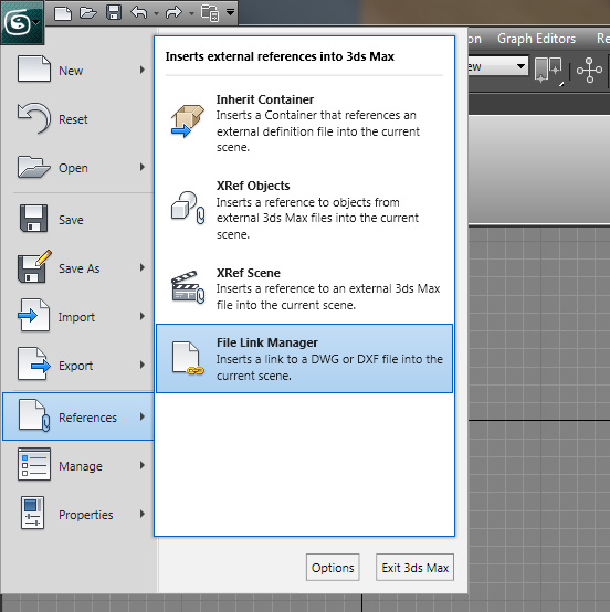

Cad64 Posted June 16, 2010 Posted June 16, 2010 I have never worked with ACA, or any files that were produced with that program, so I don't know how the 3D is generated from the 2D, or how the file reacts when imported into another program? Have you tried insterting your CAD file into Max using the File Link Manager, instead of Importing it? Why do you need to take it into Max anyway? Quote

Cad64 Posted June 17, 2010 Posted June 17, 2010 With practice, you should be able to produce nice looking renders in ACA, but in 3DS Max, you have much more control over your materials, lighting and rendering through the use of more advanced options. If I were you, I would continue trying to get your CAD file into Max. Did you try the File Link Manager as I suggested? If you're still having problems, post your CAD file here. If the filesize is too large, try posting a smaller file with just some basic elements, like a few walls, doors, windows, etc. so I can try importing it on my machine. Quote
cvc009 Posted June 19, 2010 Author Posted June 19, 2010 I exported it wrong, i just used the save file but should have used the export option it so autocad would have made solids etc. of it. Now it works fine in 3Ds and SU. Thanks for the help! Quote

hazardman Posted July 8, 2010 Posted July 8, 2010 perhaps a little late to the discussion but perhaps good for future reference... i noticed this bug if you are using a latter version of autocad architecture then max, ie ACA 2010 and Max 2009...if the CAD file was last save in plan view it will only import as a plan in 3D max..if it was saved in any other view it will be imported as 3D in Max... i beleive part of the issue is that the Architecture walls and doors and windows etc need a special AEC component to display them and it's probably switched off in plan view... the furniture and stuff that did come in 3D were "real" 3D geometry (not AEC)... the above behaviour does not happen with ACA 2008 and Max 2009--at least as far as i'm able to test...don't know if ACA 2009 and Max 2009 has any issues or if Max 2010 has the same issue ucins ACA 2011... Quote
