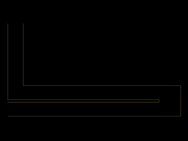

Hello
I was wondering if there is a lisp routine out there or a variation that draws a line in the middle of two polylines.
In this example, The green polylines are what is there and the blue line is what I hope to be the generated outcome of the lisp routine
Thank you very much for your help!
Actually even better is if this code can stretch the green polylines to center distance would be awesome!

Hey freerefill, thanks for giving it a shot but yeah I've attempted that before but I think if I can adjust side to side it would be good. Reason being is that I'm trying to polyline rooms following a standard so some rooms take up the area of a wall in between and some don't. Basically what I've been doing instead is deleting all the area polylines and redrawing lines where the middle of the walls or not is...then hatching them but retaining a polyline around the hatched area and turning those newly formed polylines into new room area counts. It's not the fastest way to do it but it's all I've got

Ok, I was slightly bored this evening...

Hiya Lee,
This lisp is pretty good thank you!
The only issues I've had with it is when the rooms aren't rectangular or square, let's say a L shaped room. But I still really happy with what was made so I'll have to move around those non rectangular rooms. I'll keep using this
Thank you so much, wish I knew as much as you!
