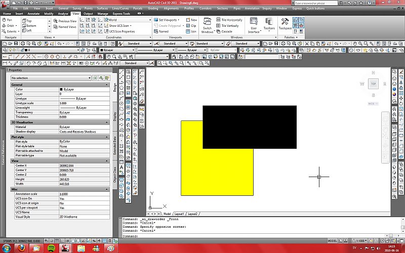

Hi, I´m using autocad civil 3d 2011 and I made a dwg with transparent hatches and it worked as it should. But now i was going to use the same dwg and print it once again , when suddently my solid hatches aren´t transparent anylonger:( I tried making new transparent hatches in new drawing but the function of the transparency dosent work anymore.
Does anyone have a solution for this problem? I took som printscreens on an example and attached to this thread.

Did this drawing get saved as a prior version, perhaps? There was no hatch transparency untill CAD 2011.
Hello Dana!
No it has not been saved in a prior version. I have tried transparency in new files on civil 3d 2011 templates, as the one in my attachement example, and there is still no transparency..:(
anyone that has a clue of what the problem comes from?

Ok found it! Command: transparencydisplay Your's is probably set to
