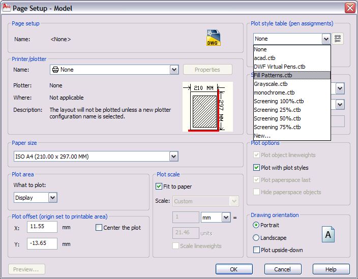

kwoky1988 Posted June 15, 2010 Posted June 15, 2010 I am an new architectural student, recently working for a research center for summer. They sent me a .ctb file which included all the line weight i needed to complete my drawing. However, I am no idea how to apply them into the layers. I am currently copying the line weight from the table manually one by one. Is there anyway i can do it automatically? Thank you very much! Quote
Pablo Ferral Posted June 15, 2010 Posted June 15, 2010 A CTB file maps line weights to colours. In this case, don't set your lineweight in your layers (Leave it set at 0.0). Instead set the colour of your layer to the colour that represents the lineweight you want . You can get this information from the CTB file (pen table). This technique is bit old fashoned now, but if it's what your client requires, then you should do it this way. IMO Your client should be able to help you apply their CAD standards. Why not give them a call and see if they have a written CAD standard you can refeer to? (i.e. One with a table that tells you which colour represents which line weight!) I would be supprised if you client didn't also have a list of layers that they wanted you to use. They probably have a table of layer names and colours ready to go. Remember - 'The only silly question is the one you didn't ask!' Quote
rvpas Posted June 15, 2010 Posted June 15, 2010 Hi, The CTB file is the plot style used for plot with standart of architectural firm. You just transfert in plot styles directory Go to Output tab/Plot panel/plotter Manager and open plot styles After when you setup to plot choose your plot style table see image below But you have to use a firm template also ? Bye Pascal Quote

ReMark Posted June 15, 2010 Posted June 15, 2010 From your AutoCAD Help file. Plot Style "Changes the plot style associated with the selected layers. If you are working with color-dependent plot styles (the PSTYLEPOLICY system variable is set to 1), you cannot change the plot style associated with a layer. Clicking the plot style displays the Select Plot Style dialog box." A color-dependent plot style file has been given to you. Open it using the Edit option found to the right of where the plot style name is shown in the Plot dialog window (see screen shot above - upper right hand corner of window). Then look on the Form View tab. Quote
rvpas Posted June 15, 2010 Posted June 15, 2010 If you work with ctb plot style, you have to know what colour to to assign for each object of your drawing. Example : Walls=>Blue, Doors=>Red etc. But if your drawing use STB plot style in this case, lineweight are assigning with layer. I have one question, why your firm sent you a ctb file. normaly, they would be send a stb file also ? Quote
ReMark Posted June 15, 2010 Posted June 15, 2010 Named plot styles (STB) can be assigned to layers or objects. Color-dependent plot styles (CTB) use an object's color to determine the lineweight. Quote
