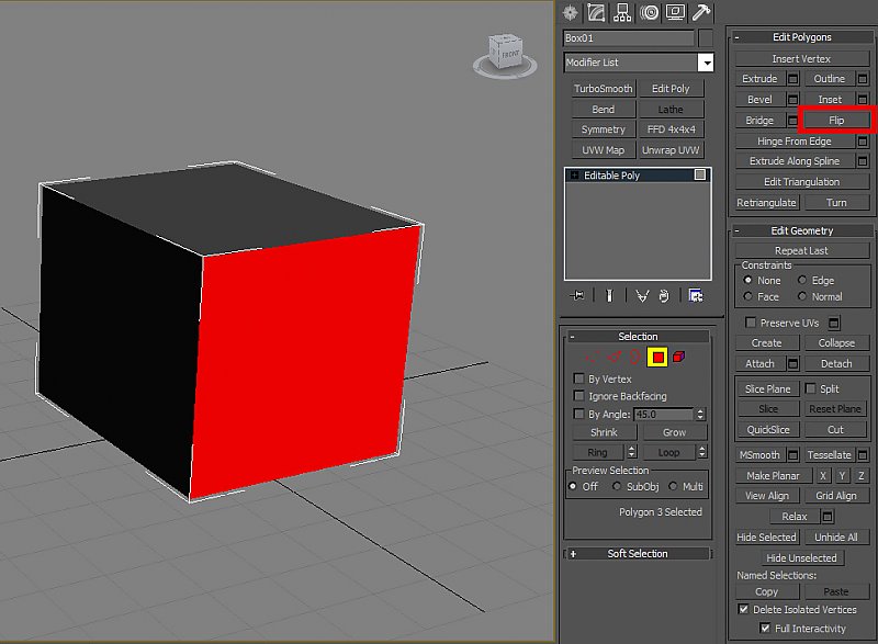

Those black areas are probably flipped. This is a common problem when Importing CAD models into Max. Just switch to Polygon selection mode, select the black poly's and then click the "Flip" button.

:? It should have worked. Did you convert your model to an editable poly before trying to flip?

You said: "I selected the polygon icon, then hit flip"
But this is what you should have done: Select the polygon icon, select the black poly's, then hit flip
