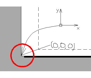

ok. i working in paper space.
what i want to do put origin in bottom (left side).
i know how to do that but it takes a lot time to do that.
maybe somebody knows fast way.

Could you explain a little more of what you mean? The origin of what?
screenshot for better understanding
You can use the move ucs tool on the View drop down menu, but you would have to find out your paper size margins to move it accurately, which is easily done by looking at the page set up and paper size.
May I ask what the purpose of moving the ucs in paper space would be?
i want to put point in this place.so i could snap.
Just move the entities from your reference point to 0,0,0. No need to move the UCS.
