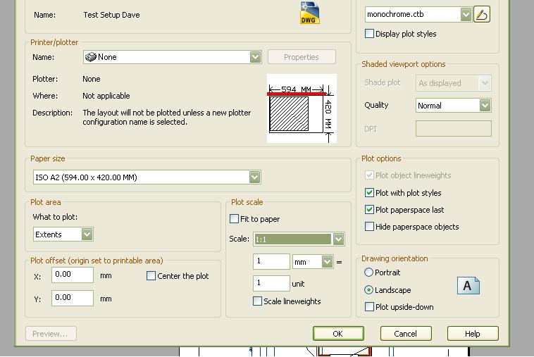

Then if I click page setup it looks like this:
(please view image 2.jpg)
Everywhere I've read seems to tell me to print "extents", but then it only seems to cover 2/3rds of the page?
Can someone help me sort this out?
Everywhere I've read seems to tell me to print "extents", but then it only seems to cover 2/3rds of the page? Extents means everything that you have drawn, even if its just 2/3ds of the page - I would suggest use Layout instead, but that is more a preference methinkgs.
Can someone help me sort this out? We can :)

just so i have this clear, if you look once more at the first jpeg i attached, that white rectangle corresponds to my A2 piece of paper, and the larger rectangle is the 'grips' of my viewport. what does the dotted line represent?

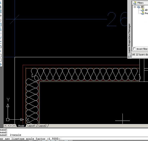

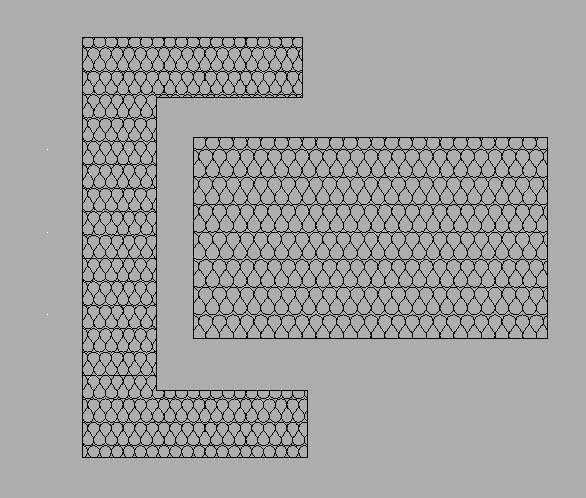

secondly, i do want to try and figure out what went wrong with that giant batting in my paperspace.
in my model i wanted to show insulation, so what i did (and this is probably wrong), was draw a line through the middle of the space that i want insulation to show up in (first image - the line i've circled in blue represents this line)
then i changed the linetype to batting, and increased the scale until the linetype was big enough to fit in there (6.9 was what i settled on. jpg # 2!)
then i when i click on my paperspace i see just one giant piece of batting (you can see this in the first image of my original post).
what exactly did i do wrong, and what's a better way to go about doing this?

The dotted line is the margins, what is inside in the dotted lines is what you can plot. Check out the Page Setup Manager to see how to change the margin settings - and much more!
The dotted line is your printable area. You will want to zoom in really close to the grips on your viewport and move them to just inside that dotted line by a couple of 0.010's.
If the viewport is positioned outside the printable area, AutoCAD defaults an ugly frame around the drawing at the edge of the printable area. At least it does it to me.

The only way to change the "margins", that I found is to change the paper size and/or orientation.
The margins can be affect by the settings on the Printer as well, or rather the paper-settings on the Printer.
That is correct. Thanks for reminding me. At My last job, the plotter had a custom option to run all the way out to what IT thinks is the edge of the page, or shrink it up to a silly little bit, Never needed it for anything, though.
On most plotters the default is about 1/4" to 3/8" off the edge. That is usually good enough.

you can adjust printable area at page setup manager.first you have select printer then go properties. here you can modify it.i prefer set to 0 all.
if you want frame you have draw rectangular.then you ploting select window (under page setup manager) and select all rectangular.then plot offset set x-20,y-10,
so if you will do this you will have frame 20 mm from left side, and ten from botom.
you have to draw right size regtangular if you want to have nice aliment.
thanks guys! any ideas regarding my problem with the giant batting linetype?
It could be the linetype scale being large, and a regen being needed.
If your drawing looks rough or silly or you can't zoom properly at times, just type regen to regenerate the current view, or regenall to regenerate the entire drawing.
AutoCAD will take shortcuts in displaying your drawing image at times, to save memory space. It will turn arc's and circles into faceted arches, skinny up the lines, and drop or skew random stuff.
Complicated linetypes are often messed up until a regen is done.
