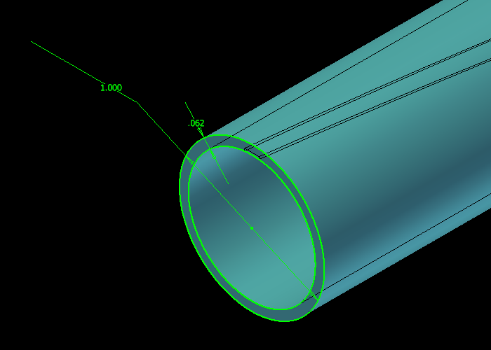

I would start by Extruding the barrel profile to the desired length... I used 24" here:
[ATTACH]20777[/ATTACH]

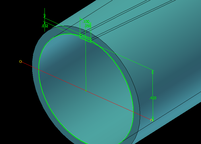

Make your rifling profile to be cut with the coil feature:
[ATTACH]20778[/ATTACH]

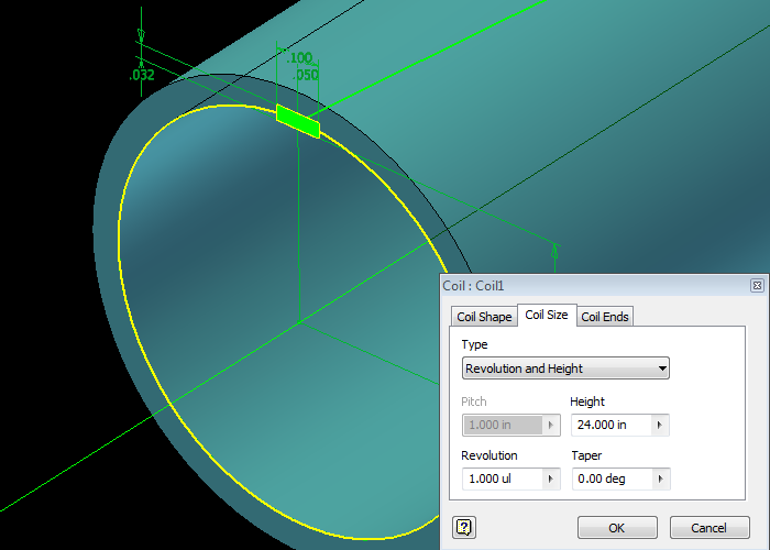

Create your coil using revolution to height ratio. (don't forget to use the cut option):
[ATTACH]20779[/ATTACH]

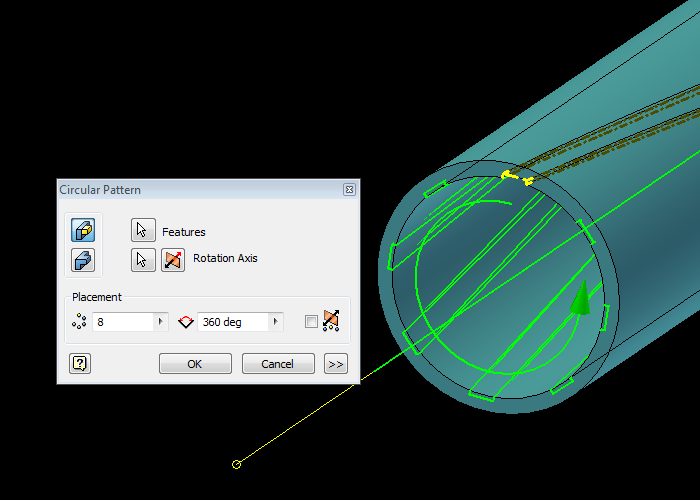

Now circular array your cut coil 8 times or what ever is required:
[ATTACH]20780[/ATTACH]

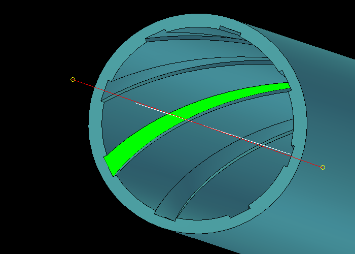

Finish:
[ATTACH]20781[/ATTACH]

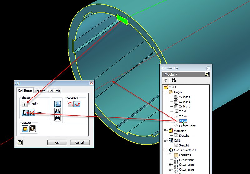

Hmm, well thanks however I can't seem to get the coil tool to pop out the OK button. Probably due to me forgetting how to use the coil tool, so I'll go look that up real quick.
-Thanks,
Viu
Don't forget to choose your axis...
KC
KC
I'm gonna sound like such a newbie, but how do I select the z axis?
You may have to click on the arrow in order for the axis to highlight in the browser.
KC
[ATTACH]20782[/ATTACH]
KC
Worked, thanks!
