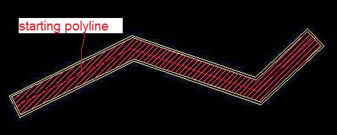

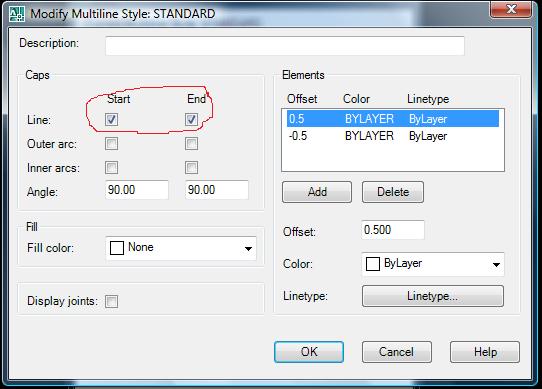

manirpg Posted June 10, 2010 Posted June 10, 2010 Dear friends, i need lisp or macro for ... Close caps by line in standard mlstyle If possible help me....... Regards mani Quote
Tharwat Posted June 10, 2010 Posted June 10, 2010 Hi Actually What is the entitiy codes for these points ( start & end ). Regareds, Tharwat Quote
Lee Mac Posted June 10, 2010 Posted June 10, 2010 i need lisp or macro for ... Why don't you learn to write them then? Quote
Lee Mac Posted June 10, 2010 Posted June 10, 2010 Actually What is the entitiy codes for these points ( start & end ). The Styles are stored in the ACAD_MLINESTYLE Dictionary, the cap settings (among other things) are stored in Group 70 of the Style dictionary item. Example to find which properties are set: (defun GetMLineStyleProps ( style / dic ) ;; © Lee Mac ~ 10.06.10 (if (and (setq dic (dictsearch (namedobjdict) "ACAD_MLINESTYLE")) (setq dic (dictsearch (cdr (assoc -1 dic)) style))) (GetBits (cdr (assoc 70 dic))) ) ) ;; GetBits ~ © Lee Mac ;; Returns the bit combination of a number (defun GetBits (n / b) (if (< 0 n) (cons (setq b (expt 2 (fix (/ (log n) (log 2))))) (GetBits (- n b)) ) ) ) (GetMLineStyleProps "Standard") Quote
Lee Mac Posted June 10, 2010 Posted June 10, 2010 Example of modifying properties... ;;; 1 = Fill on ;;; 2 = Display miters ;;; 16 = Start square end (line) cap ;;; 32 = Start inner arcs cap ;;; 64 = Start round (outer arcs) cap ;;; 256 = End square (line) cap ;;; 512 = End inner arcs cap ;;; 1024 = End round (outer arcs) cap (defun PutMLineStyleProps ( style code / dic ) ;; © Lee Mac ~ 10.06.10 (if (and (setq dic (dictsearch (namedobjdict) "ACAD_MLINESTYLE")) (setq dic (dictsearch (cdr (assoc -1 dic)) style))) (entmod (subst (cons 70 (boole 7 (cdr (assoc 70 dic)) code)) (assoc 70 dic) dic ) ) ) ) Quote

manirpg Posted June 11, 2010 Author Posted June 11, 2010 Dear Lee, Actually I am biginner for Lisp.......... How can i use ur code.......... I did't get result.... help me? Thanks Regards mani Quote
Lee Mac Posted June 11, 2010 Posted June 11, 2010 Use the code posted in post #5 with the correct stylename and bit code combination for what you want to achieve, Example for Inner Arcs at start and end: (PutMLineStyleProps "Standard" (+ 32 512)) Quote

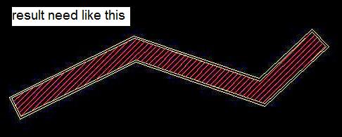

manirpg Posted June 12, 2010 Author Posted June 12, 2010 :)Hi Lee, I am really very sorry, becoz my achivement for this one is somthing different. i am using one of bad route, becoz i don’t have much experience in lisp. but it helps last two years lot lot. (for preparing this taken for 3 month for me). I know this is very simple lisp for you and others. My target is (need lisp) I want a hatch patten like rectangular polyline. 1.draw polyline(user input) 2.offset polyline both side (offset value user input) and erase middle line 3.connect both offset lines by polyline and join all by pedit (end to end & end to end) 5.offset out side 200mm 6.hatch it(only centre) & ready to next process See the attachment Options: 1.offset both side 2.offset any one side But How i did it in macro, 1.mline(with offset)(with end to end cap) 2.xplode 3.pjoin 4.hatch if i am using this in to new dwg, need to close mlstyle cap manually every time, thats why i posted this thread Help me.............. Thanks lot Mani Quote
