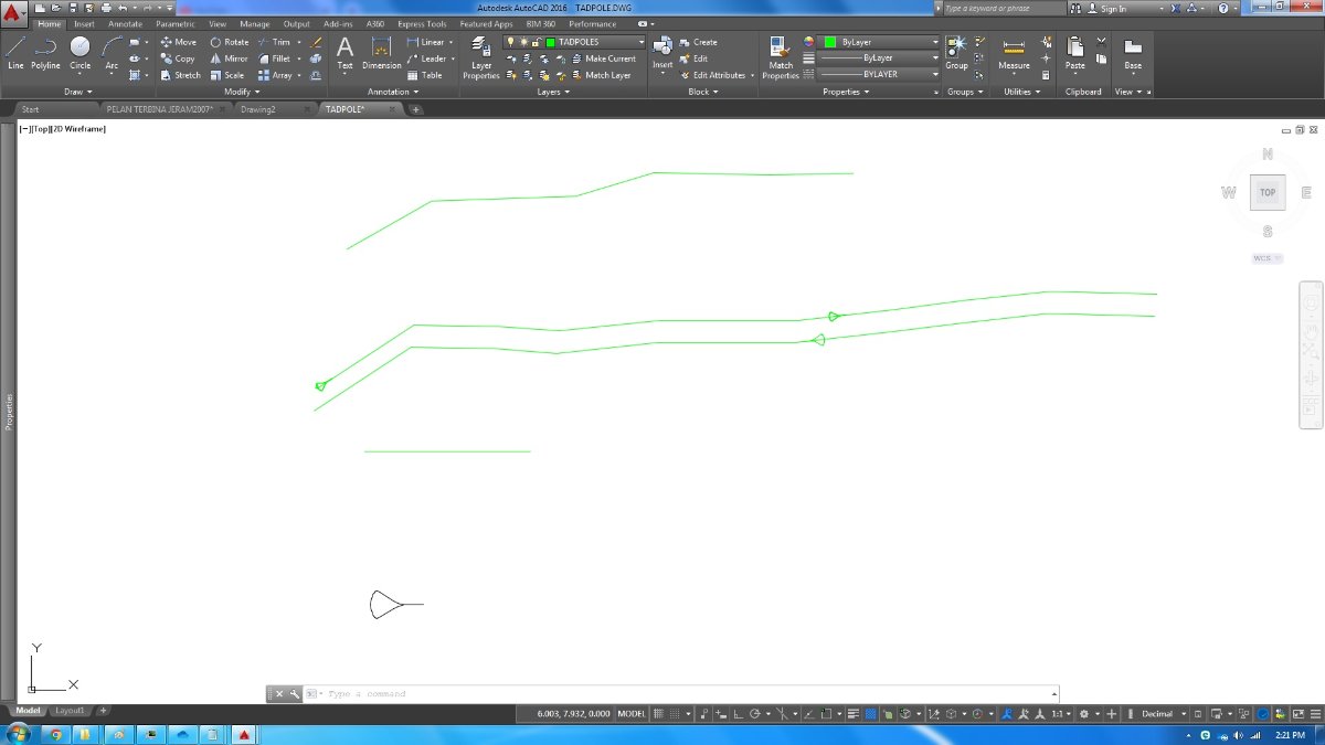

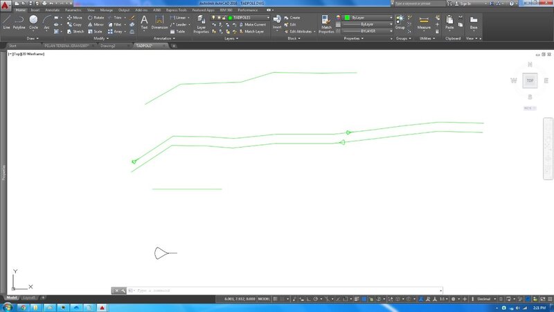

bogdancic26 Posted June 10, 2010 Posted June 10, 2010 Hi I have an old routine that inserts a block (tadpole) and align it to two points. What I want is to select top of slope and bottom of slope and enter at a certain distance (eg 10 m) that block scaled and aligned to the top of slope, which would command something like "measure" but I want to scale that blocks according to the distance between the two lines. My knowledge of LISP is not great - I can sometimes see what it's doing and might me able to cut and paste code from one file to another, but as of yet, can't write the code myself. Another problem is if one of polylines is shorter than the other (as in "test.dwg) block insertion end to end where the shortest. TADPOLE.DWGFetching info... tadpole.lspFetching info... test.dwgFetching info... Quote

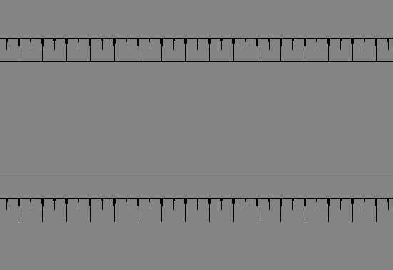

bogdancic26 Posted June 11, 2010 Author Posted June 11, 2010 I found two routines approaching what I wanted. http://www.cadtutor.net/forum/showthread.php?t=20483&highlight=batter+ticks&page=2 post # 18 Here the problem is that the batter ticks not always align the top of slope to bottom of slope according to the direction of polyline, as shown in the attachment. The second is http://www.cadtutor.net/forum/showthread.php?t=25747&highlight=batter+ticks. Here there is the possibility to choose which side I draw the batters ticks but if the bottom of slope and top of slope have different lengths crash and delete polylines.If someone can look and find the answer to any of them to work properly would be perfect and I would be obliged. Thanks in advance Quote
