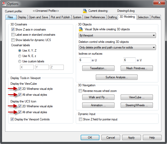

Managed to solve the question and it is seems rather simple. Type in options and under the 3D modelling tab there is a check box that say 2D View Cube and UCS Icon on or off, just uncheck the on box

You can turn them off permanently without LISP in the 3D Modeling tab of the Options dialog.
Thanks kalmdown,
Your suggestion was the first thing I did but, for some reason on my system, although the view cube was turned off, the navigation bar
kept comming up. Since I added that simple line to the acad2011doc.lsp support file I haven't seen either of them. You can also use this line: (command "_.navbar" "off" ) in place of the one I posted previously. The acad2011doc.lsp file is located at - -
C:\Program Files\Autodesk\AutoCAD 2011\Support - - in Windows7.

You can also type "cube" at the command line (as opposed to "navvcube"). But, yeah, the best way to keep it off is what 007 said - Go to Options, 3D Modeling tab, uncheck the box(es).
