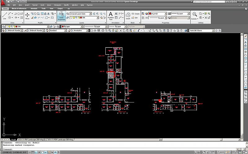

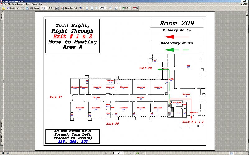

To clarify, i am drawing egress plans for fire and tornado evacuation. The building i am drawing is in a "T" shape. For me to effectively produce the egress plans by room on 8.5 X 11 sheet it is neccssary for me to split the three wings apart in the Model Space. ( see model Space Screen Shot)
However When I Split these three wings I have to bind the Xref, I was wondering is it possible to split the three wings without binding the xref, And, if i did accomplish this would things such as walls and other modifications be reflected in the egress drawings just by updating the "gold" file.
