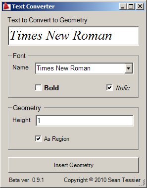

SEANT Posted June 12, 2010 Posted June 12, 2010 Here is a utility (Beta version) for inserting text based geometry directly into AutoCAD 2007+. All curves in the geometry are spline based; though remain compatible with Piecewise Cubic Bezier curves. Not all Font definitions are compatible with the “As Region” option. This is essentially an open source project http://www.theswamp.org/index.php?topic=31435.0 (You will need to sign up as a member to view the link) To load: Command: Netload Browse for Text2Geom.dll To run command: Command: t2g Disclaimer: As with any beta software, the user should exercise sensible caution. THE AUTHOR PROVIDES THIS PROGRAM "AS IS" AND WITH ALL FAULTS. THE AUTHOR SPECIFICALLY DISCLAIMS ANY IMPLIED WARRANTY OF MERCHANTABILITY OR FITNESS FOR A PARTICULAR USE. THE AUTHOR DOES NOT WARRANT THAT THE OPERATION OF THE PROGRAM WILL BE UNINTERRUPTED OR ERROR FREE. TNRI.dwgFetching info... T2G.zipFetching info... Quote
