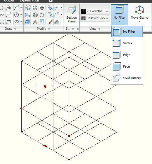

Hii,
Yes you can select a face, edge, point.
Just hold CTRL key vhen you select one of us.
And you can filter your selection
Home/Subobject tab
Bye
Pascal
Ah, perfect thanks! I'll have to add that control to my ribbon. I must have removed it, stupidly.
