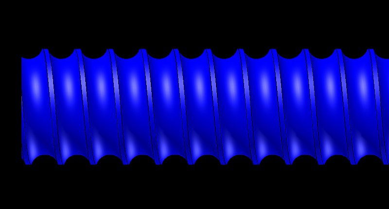

max2017 Posted June 7, 2010 Posted June 7, 2010 (edited) I need to deswign the following ball screw, some one knows how? i tried with thread tool but i couldn´t., any tips? i am using inventor 2010 I attach other file where i did a ball screw in tha last post. Edited August 31, 2010 by max2017 Add final work. Quote

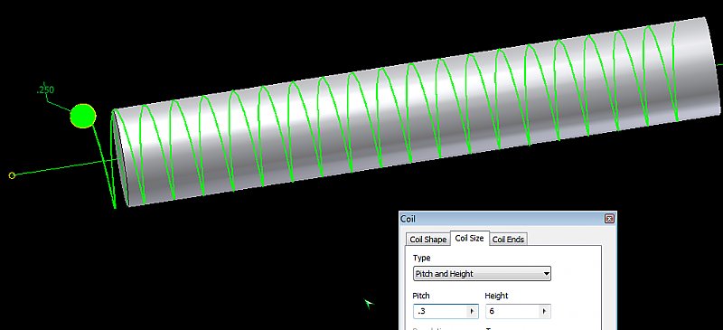

kencaz Posted June 8, 2010 Posted June 8, 2010 The thread feature applies only a bitmap image of a thread. Use the coil feature to cut the threads using a profile the diameter of the ball. KC Quote

max2017 Posted June 8, 2010 Author Posted June 8, 2010 how do you calculate the diameter of the ball?, is the same as the leaD and also i need to select the meddle of the ball or the external diameter? sorry but i am new in this area. Quote
kencaz Posted June 8, 2010 Posted June 8, 2010 I would assume a .2 diameter ball per your drawing. Your pitch will determine the ball offset center to center. You don't need to select the middle of the ball. when you select the "Coil" feature it will start in the middle of your ball profile. KC Quote
numberOCD Posted June 8, 2010 Posted June 8, 2010 Algebraic approximation: With 140 degree concave dip, and the length of single thread (1/threads-per-inch) = x, to get the relative ratio of flat filleted edge to dip depth and width use a circle with diameter 95% of x (0.95x) and set the radius of the coil to the radius of filleted edge plus 18.2% of x (R+0.182x) Quote

max2017 Posted September 1, 2010 Author Posted September 1, 2010 Here is the link of my final work: Download Here I dont like how the trhead starts, is there any step to make the beginning of the thread more fine like it starts with a little point? Quote
JD Mather Posted September 1, 2010 Posted September 1, 2010 I have just started to take a look at this thing, but I can't figure out what the purpose of WorkAxis1 is? Isn't it just a duplication of the Orign Z Axis? Can't figure out why use used Loft1 rather than a simple Chamfer? Workplane1 doesn't look like it is needed either? Sketch2 has 2 dimensions when only one is needed? (use = constraint) Sketch6 has 4 dimensions where only one is needed? Sketch10 is unconstrained (and won't result in correct geometry anyhow - but I'll come back to that later). Quote
