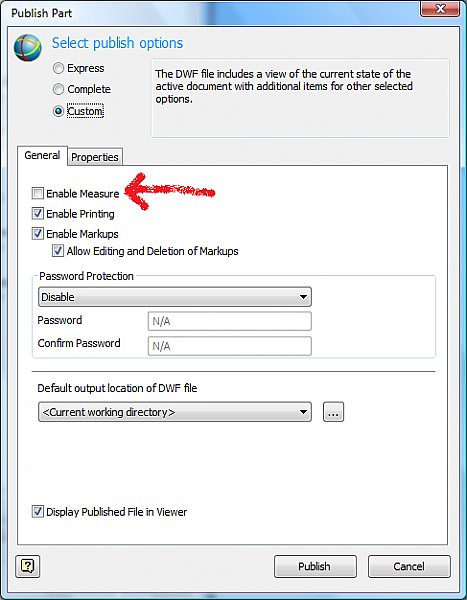

You should be able to take measurements in Design Review unless the originator of the intellectual property elected to turn off this functionality to protect their property. Probably the easiest solution would be to request a dwg from the owner of the IP.
