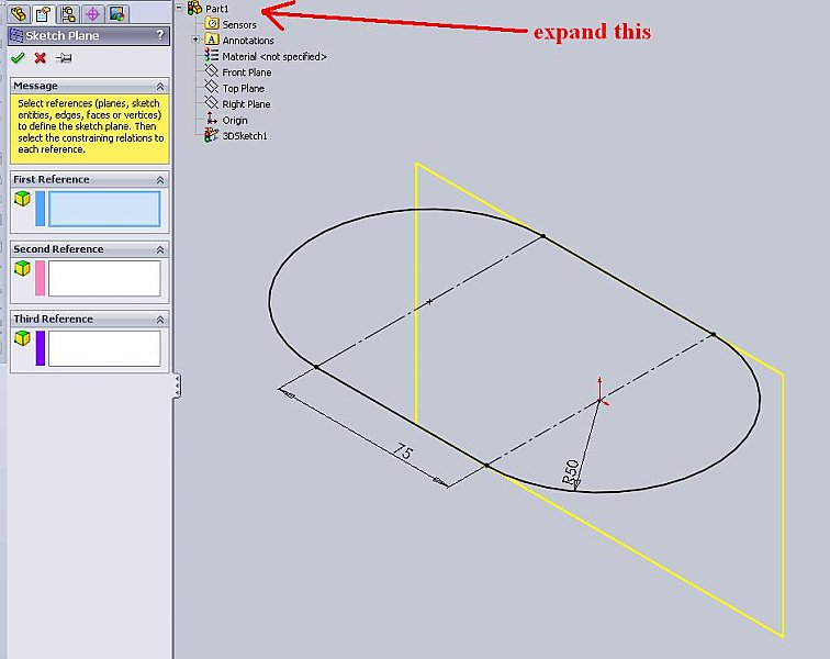

Bobzy20 Posted June 22, 2010 Author Posted June 22, 2010 Hi I wonder if anybody can help me with this small question I have. I’m new to SolidWorks and I’m currently doing this tutorial but I can’t workout/understand the tutorial. It’s defiantly me but any help would be great. As you can see from the illustration below I’ve drawn the basic part and saved it. I’ve now re-opened it (as I drew this a while ago) and then I try and follow what the tutorial says but I can’t make it work. The tutorial says: Click Isometric (Standard Views toolbar). (Done) Click 3D Sketch On Plane (Sketch toolbar) and in the PropertyManager: (I clicked on the Front Plane and selected 3D Sketch On Plane) Select Front for First Reference. (I can’t do this part as the PropertyManager window is clear.) Thanks Bobzy20 Quote

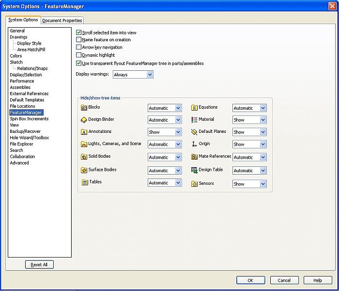

shift1313 Posted June 22, 2010 Posted June 22, 2010 When you have the property manager tab open in the feature tree, the actual tree can be seen to the right if you expand the + sign. If you don't see this go into your Tools>Options. On the System Options tab go to FeatureManager. There is a check box that says "Use transparent flyout FeatureManager tree in parts/assemblies. This will allow the feature tree shown in the first image. Quote
shift1313 Posted June 22, 2010 Posted June 22, 2010 I think I may understand your question. For your properties tab to display the planes, you need to be inside the 3d sketch. In your screen shot you are not editing your sketch. when you edit the sketch, is the properties tab still empty? Quote

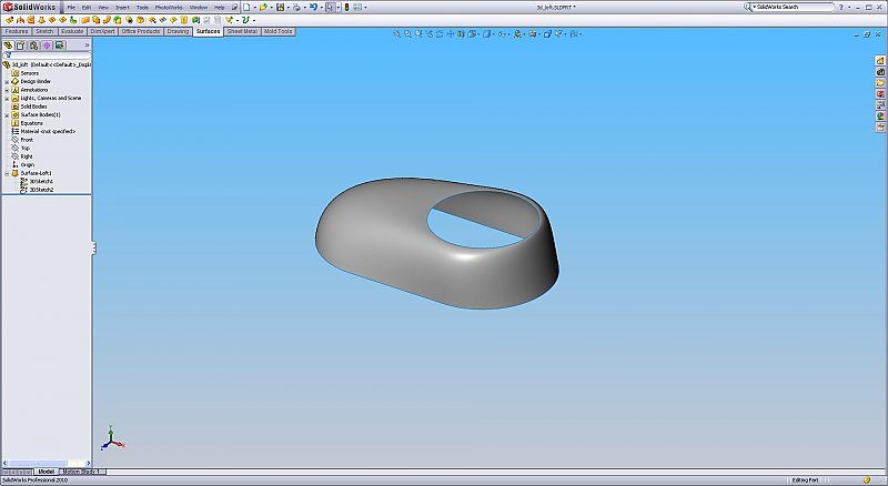

bhamze Posted June 29, 2010 Posted June 29, 2010 Hi shift1313 here is my part (zipped). Bobzy20 What problem are you having? I downloaded file and was able to create loft. I added a 3dsketch to create the front guide curve. Quote

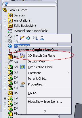

bhamze Posted June 29, 2010 Posted June 29, 2010 Hi bhamze thanks for the reply. I’m new to SW and have no idea what I’m doing! I open the drawing and then it says I need to do the following but don’t know how to: Click 3D Sketch On Plane (Sketch toolbar) and in the PropertyManager: a. Select Front for First Reference. b. Select Coincident and then click I can’t even select 3D Sketch On Plane as it doesn’t give me the option under Sketch. Thanks Bobzy20 You might need to add that tool (3D Sketch On Plane) to your sketch toolbar. If your not familiar on how to this..... in Solidworks, go to Solidworks help and type in command manager. If your still stuck let me know, I'll try to help out. You can also create a 3D Sketch On Plane by going to insert (top menu next to file/edit/view) then selecting that option. In order to create a 3d sketch on plane you first need to select a plane (top/front/right) before option can become available. If you dont the option will be ghost out and not selectable. When adding a new plane (3d or not) you need to select references in order for the software to create that plane. If no references are selected the software has no idea where to place plane and you will get error messages. In your case, when you create a new plane your first reference would be the front plane (you can select this in feature tree on your left) Under the first reference selection window you will see options for coincident,perpendicular,parallel,distance,etc.....Again in your case, select coincident, this will create a plane that sits on the front plane. Think of it as making a copy of the front plane. Quote
shift1313 Posted June 29, 2010 Posted June 29, 2010 Good info bill. bobzy, i havent opened your file yet but as bill said you need a reference. 3d sketch on plane is a little different. From your sketch menu you can select 2d sketch or 3d sketch at any time, but for a 3d sketch on plane you need to select your reference first. A 2d sketch will allow you to select the reference after. You can either select a plane, then select the drop down box for creating a new sketch. Or you can select a plane, then right click and you should see 3d sketch on plane. Quote
