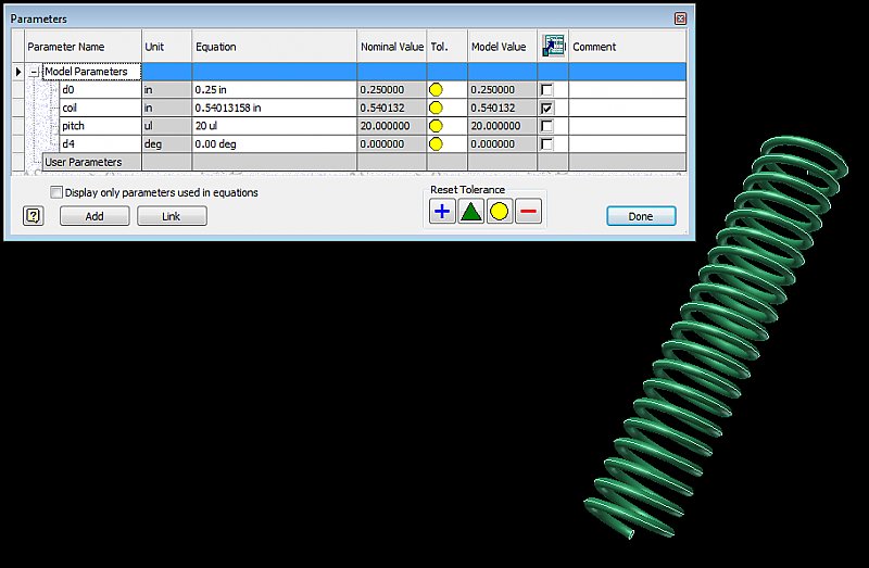

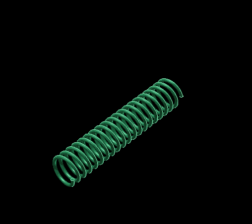

You could make an adaptive coil and drive the parameters in Studio. This will give you the look of stretching but you may be able to just get away with driving a flush constraint or something similar to simulate the motion but no stretching.
something like this:
