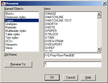

hello, can someone advise me how to rename multiple layers?
we have received drawings from outside and the drawings are bounded, we want to rename those layers with $ layers.
i have sample layers to be rename below.
Thanks again

Rename command or opt for LISP routine.
You might also look at the LayTrans command.
alanjt thanks very much it works...:)
lpseifert ths lsp is good. thanks very much also..:)
makes my life easier.......:):):)
You Can Use 'laymrg', If Working In Lt
The Layer Express Tools weren't brought over into core until 2008.
