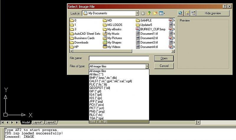

The Buzzard Posted June 2, 2010 Posted June 2, 2010 Its Autocad LT 2008 and it doesn't give you the choice to attach a image Sorry about that, I did not realize it was LT. This is an image from ACAD 2009 and you can see at the bottom that tiff as well as many other images are included. Maybe you should switch to a full version. Quote
delliott Posted June 2, 2010 Author Posted June 2, 2010 Thanks! OK, so, its the LT that doesn't support more than 3 types of files and tiff is not one of them. I use LT 2010 and another guy here is using LT 2008. 2010 allows all file types, so I will have to insert the image in to the drawing and then he can open the drawing and trace over the image. Seems to be the only solution! Quote
