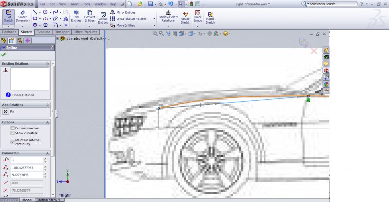

varuninnz Posted September 12, 2010 Posted September 12, 2010 hey man. I have just started on ur tutorial. just gt few quick question 1. Im using ur blueprints. but why is it that ur blueprints once loaded on solidworks are soo clear while mine are fading. I have uploaded my picture Its because of this Im finding it really hard to sketch my curves on the car.. 2. I have just combined my lines from the top sketch and right sktech by projected curve. After doing this both my top and right sketch disappered as expected. Just making, lik u said do a new sketch on right plane. So does mean we have to keep uploading our blueprints everytime we use projected curve? Thanks Van Quote

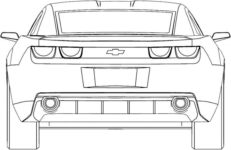

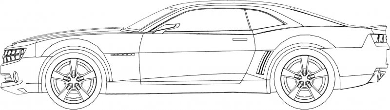

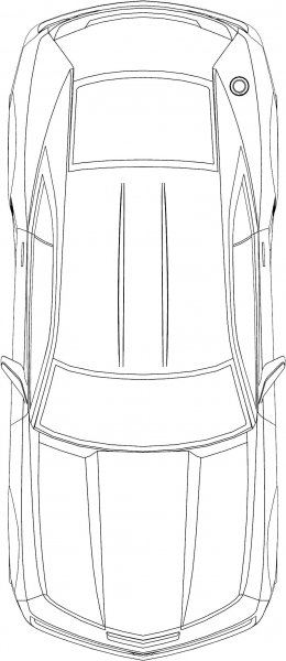

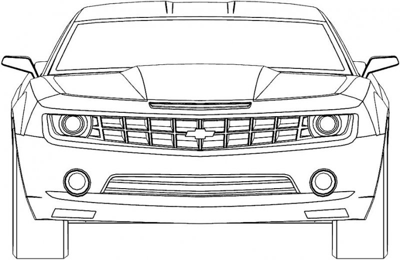

shift1313 Posted September 12, 2010 Author Posted September 12, 2010 van, im guessing the image is blurry because of size. Mine were just fine. You may try rescaling everything so its smaller. Make sure also when you split the images off the original file that you didnt save them in a different format like a 16 color bitmap or something. I kept mine as jpeg's. Ive attached the files again for you. For the blueprints. I think i specified to create a sketch with only the blueprints in before drawing anything. You want sketches with no lines, only the images so you can hide them or view them when needed. You will not need the image in the same sketch for exactly the reason you mentioned. You can turn the sketch you drew back on but I would suggest just starting 4 sketches on the various work planes for your blueprint images. If you look at the first image I uploaded(i think page 3 where the tutorial starts) you can see the 4 images and their respective sketches(re named). Quote

shift1313 Posted September 12, 2010 Author Posted September 12, 2010 thats weird. the images I uploaded are jpeg's. Does it tell you what format it thinks they are? If you right click on the pictures I uploaded and look at picture info it will tell you the size and file type. Make sure when you Right Click on the pictures above you Save Image As. Double check that your file type is jpeg before you save them. Quote
varuninnz Posted September 13, 2010 Posted September 13, 2010 dont worry mate. i restatrd my computer and saved em again. it workd thanks Quote
