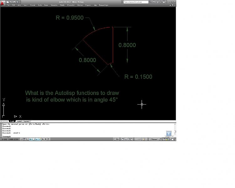

Hello everybody,
I have made an Autolisp file to draw elbow in 90 degree but this one in
45 degrees make me crazy with some funtions that could not reach its directed location.
I hope that anyone could help and it would highly appreciated.
Tharwat

tharwat313,
The attached program just does elbows. It was a program I had tinkered with before I did my RMD.lsp as seen in my signature below.
If anything the program may give you some idea how to do this for yourself.
I think you should enquire about Lee's program all the same. It looks well worth it.

Here is another copy of the previous program I posted except this time it uses a list for the angles instead of lots of variables. Hope this make it easier for you.
This one is called ELBOW2.lsp
Type ELBOW2 to start.
If this does not suit you, Please post your program and maybe we can locate your specific problem.
It is hard to give an answer to a vague question. You are not giving enough details about the problem.
ELBOW2.lsp

here is one of the Autolisp files that I made, and it does help me a lot in mechanical plans, so I tried to make an autolisp file as well but in 45 degees and unfortuntly I could not.
So I hope that you would have time to help me to with it.

I can see that you are doing it in line and arc segments. The lisp I supplied you with is done as a closed polyline. Also the file sets layers, linetypes and colors. It is also doing the elbow at different angles that you can select. Insulation option is also in there as well and error trapping plus user settings. That why it looks so big to you. I thought you could review that and take what was needed. Since you are doing this a bit different I will take a look and see what I can find in your program. I will get back to you later.
Ok, Here is a compact version.
No layers set and no looping. Just a 45 degree elbow with a choice of Left or Right direction and choice of Sizing. I left the error trapping in as this is best. The elbow is constructed as a closed polyline. Better as one object than lots of loose pieces. The elbow can be inserted in any direction. Program has metric defaults and will remember the last entries. You may modify this program to your likings.
If you have any questions I will answer them.
See attached.
Program Name ELB45.lsp
Type ELB45 to start.
ELB45.zip
Here is a second method as I had shown earlier using a list to store the angles and reduce a set of calculations.
Program Name ELB45-2.lsp
Type ELB45-2 to start.
ELB45-2.zip
