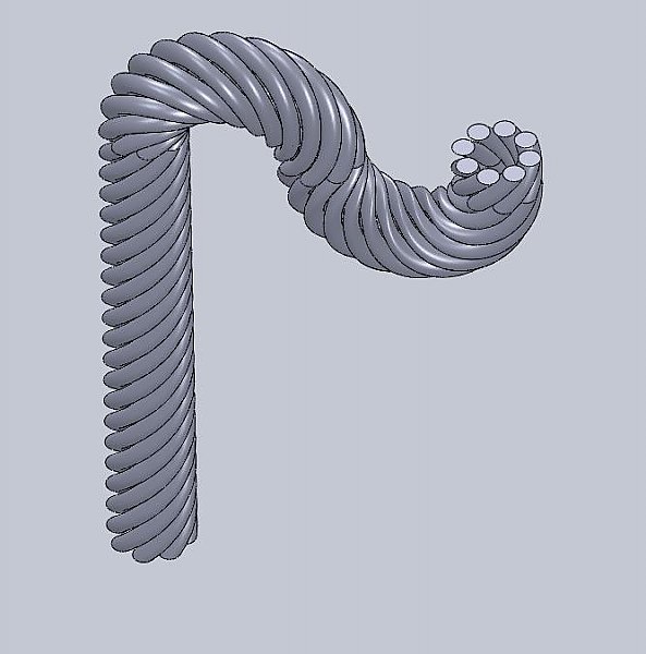

Be_cool Posted June 2, 2010 Posted June 2, 2010 I have to create coil around existing part or skech just like on the picture... Thanks for help! Quote
Be_cool Posted June 2, 2010 Author Posted June 2, 2010 This should be some kind of elevarot rope so can u explane me how to use band tool on this particular example...or maby u have better solution. Thanks! Quote
Be_cool Posted June 2, 2010 Author Posted June 2, 2010 Problem with coil is that u have to specify type (pitch and heigh or...) is there any option to specify sketch as a path, just like with sweep tool? Quote

shift1313 Posted June 2, 2010 Posted June 2, 2010 I cant remember off the top of my head if this works in Inventor 2010 but in solidworks I would sweep the cable sketch along the path and use the Twist along path option. in this image I did that and twisted 5 times. It would need some tweaking to get a good result but i think it might be the easiest method. Quote

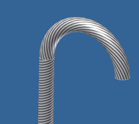

kencaz Posted June 2, 2010 Posted June 2, 2010 I know what it looks like. I was after more information of the why. I could do a cosmetic texture that by the time you back up a bit and view it in the context of the rest of the assembly you would not be able to tell if it was modeled or texture. But you sure would be able to tell by the speed (or lack of) of operations. I see a lot of people go to the trouble of modeling down to the last detail stuff they will purchase off-the-shelf (like wire rope). Why? Time is money and cosmetic can look just as good. I agree, why try to model a cable, just use a texture. You can almost get away with a "Threaded" texture. KC Quote
JD Mather Posted June 2, 2010 Posted June 2, 2010 You can almost get away with a "Threaded" texture. You might want to use a spline as the sweep path for a continuous texture or Create several textures at different rotation angles and apply by face rather than by part. Once applied you can interactively drag the angle in the Styles Editor to get the textures lined up. Quote

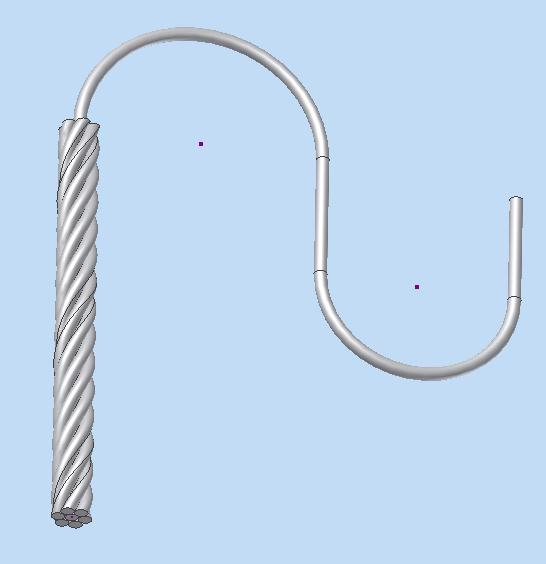

Be_cool Posted June 3, 2010 Author Posted June 3, 2010 ty all for great post's!!! shift1313 did grat job with solidworks but sadly it cant be done in inventor. Hmmm....can i use solidworks model in inventor with possibility of editing and constaining?! JD Mather can u explain me, more closely, how to create several textures at different rotation angles and apply by face? At least i want to have same texture along the whole rope. Quote
JD Mather Posted June 3, 2010 Posted June 3, 2010 ... sadly it cant be done in inventor. . Post ipt file here with dimensioned path sketch and circles sketch and I'll show you how to do it both ways - modeled or cosmetic. Quote
