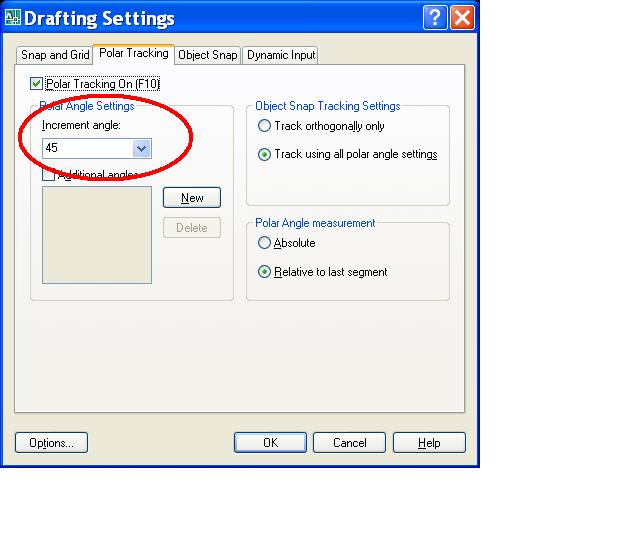

if you want to draw a line from a specific point at a 45 degree angle, how do u do this?
cheers
This will draw a line from 0,0 10 units long at 45 degrees
Command: line
Specify first point: 0,0
Specify next point or [undo]: @10<45
or set up Polar Tracking with the angle @ 45
Command: pl PLINE
Specify start point:
Current line-width is 0.0000
Specify next point or [Arc/Halfwidth/Length/Undo/Width]:
Angle Override: 45
