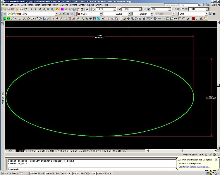

gsksun4 Posted June 1, 2010 Posted June 1, 2010 I'm trying to dimension the diameter of the elipse in the attached dwg. I do dimension, diameter and it asks to select the arc or circle. I select the elipse and it tells me it's not an circle or an arc. I know this, but see no other option under dimension for elipse. ISO.dwg Quote
mdbdesign Posted June 1, 2010 Posted June 1, 2010 Snap to quadrant your dimension line. I think you can dimension only long and short axis and lengthen of ellipse. Quote
gsksun4 Posted June 1, 2010 Author Posted June 1, 2010 Snap to quadrant your dimension line.I think you can dimension only long and short axis and lengthen of ellipse. I have my osnap/quadrant set to on, but it doesn't snap to the quadrant of the elipse. You lost me on the long and short axis thing. BTW, I'm using 2009LT. Quote
Ryder76 Posted June 1, 2010 Posted June 1, 2010 Set your osnap settings to quadrant then dimension as shown. Quote
gsksun4 Posted June 1, 2010 Author Posted June 1, 2010 Set your osnap settings to quadrant then dimension as shown. [ATTACH]20420[/ATTACH] Could you look at the elipse in the drawing I attached. I got the snap/quadrant to work, but the elipse is in isometric. It snaps to a quadrant, but not right for a dimension as you have shown above. Also, what type of dimension should I use? Aligned? Quote
mdbdesign Posted June 1, 2010 Posted June 1, 2010 Ok I did not open your dwg. Draw temp lines from midpoint of outside face edges across ellipse (like ellipse center line) and dimension between intersection of ellipse and lines. Quote
gsksun4 Posted June 1, 2010 Author Posted June 1, 2010 Ok I did not open your dwg.Draw temp lines from midpoint of outside face edges across ellipse (like ellipse center line) and dimension between intersection of ellipse and lines. Sorry, but I'm confused with this. Not sure what you mean by midpoint of outside face. I will have to continue this tomorrow, as I must leave work now. I appreciate your input. Quote

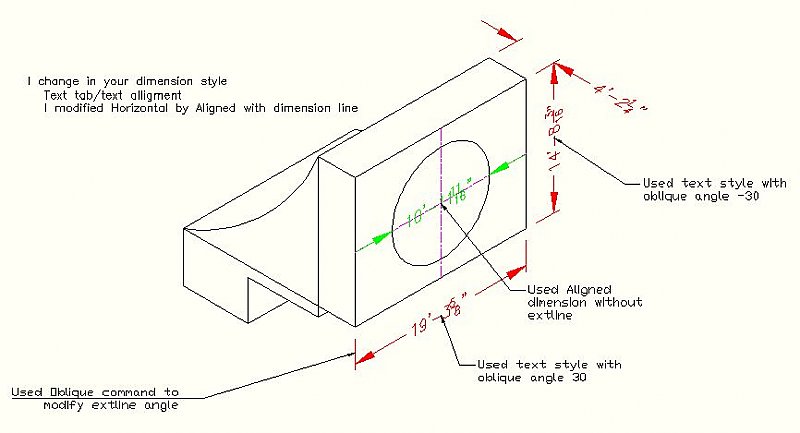

rvpas Posted June 1, 2010 Posted June 1, 2010 Hi, i opened your drawing and I noticed you used ISOcircle in Ellispe command. ISOcircle it is not circle for autocad and that is why you dimdiameter do not work. The only way to get a diameter, you have to use Aligned dimension and turn off Extension line 1 and 2 in my opinion or like CJJ said use MLEADER. I have some comments about your dimensions see attached image and dwg Bye Pascal ISOmodifHPA.dwg Quote

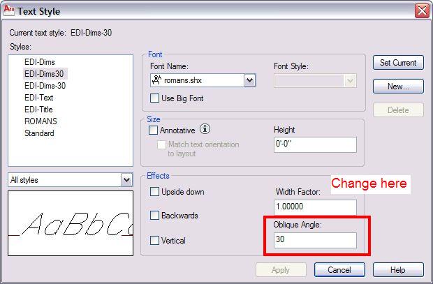

gsksun4 Posted June 2, 2010 Author Posted June 2, 2010 Hi,i opened your drawing and I noticed you used ISOcircle in Ellispe command. ISOcircle it is not circle for autocad and that is why you dimdiameter do not work. The only way to get a diameter, you have to use Aligned dimension and turn off Extension line 1 and 2 in my opinion or like CJJ said use MLEADER. I have some comments about your dimensions see attached image and dwg Bye Pascal Pascal, thanks so much for going the extra mile here. I'm new to dimensioning so I'm experimenting with this drawing. I'll take note of your instructions. I do have one question for you. When you wrote you changed the text style oblique angle, do you mean in the dimstyle mgr under text, or the style mgr? I don't see a way to do it in the dimstyle mgr. Thanks again, Glenn Quote

rvpas Posted June 2, 2010 Posted June 2, 2010 Hi Glenn, When I wrote you changed the text style oblique angle it means to change your text angle in your text style see attached image. You have to create two text style with oblique angle 30 an -30 because his choice depending on orientation of your dimension. See my drawing and check red dimensions properties Bye Pascal Quote
gsksun4 Posted June 2, 2010 Author Posted June 2, 2010 Hi Glenn,When I wrote you changed the text style oblique angle it means to change your text angle in your text style see attached image. You have to create two text style with oblique angle 30 an -30 because his choice depending on orientation of your dimension. See my drawing and check red dimensions properties Bye Pascal Thanks for the follow-up Pascal. Got it. Glenn Quote
