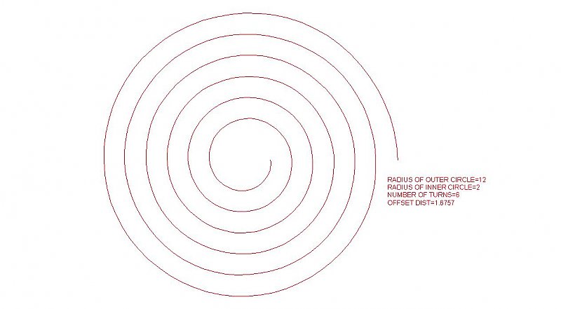

How many turns in your coil?
What is the radius of the inner and outer circles?
An example for you.
I neglected to mention one important fact. You have to use the FLATTEN command on your helix.

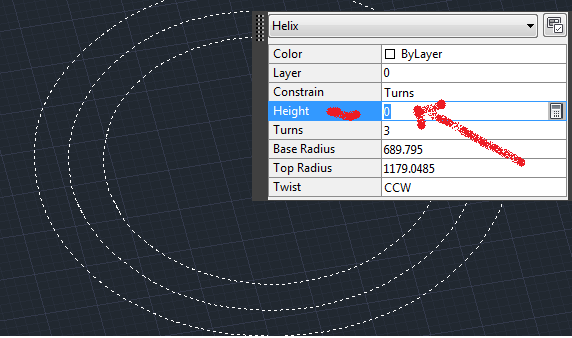

Not really. You can set the Turn Height to 0 for a coil during creation (or change it after the fact).
