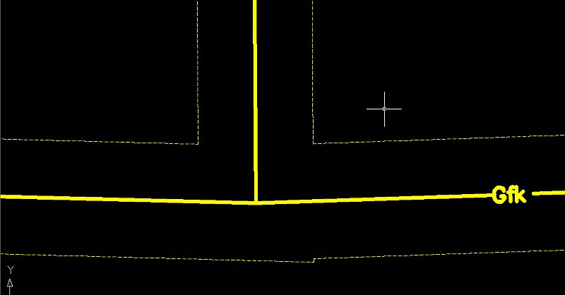

M76 Posted May 31, 2010 Share Posted May 31, 2010 I need to join lines together into one polyline. The problem is that sometimes if there is a T junction, it will join the branch line to either part of the main line. What do I need it to do to join the lines that are close to each other in angle, and keep the other ones seperate. ? Is there an option besides manual supervision of each joint? Quote Link to comment Share on other sites More sharing options...

M76 Posted June 1, 2010 Author Share Posted June 1, 2010 There are a couple hundred files, and each with thousands of lines, manual labour is out of the question. Especially because this routine has to be completed on a file each time its changed. If there is no other way I'll have to compare the angle of each line ending in a lisp, and determine which ones to join. This is only a small part of a bigger project. I need to create buffer zones around the lines, and if the lines don't connect correctly the buffer won't look right at these junctions. Quote Link to comment Share on other sites More sharing options...

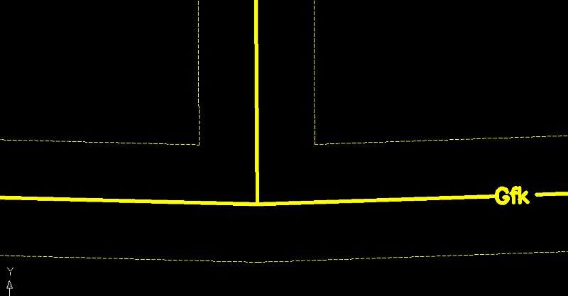

M76 Posted June 1, 2010 Author Share Posted June 1, 2010 Here is an example what will happen if the lines are joined incorrectly, and how it should look when the lines are connected the right way. Quote Link to comment Share on other sites More sharing options...

M76 Posted June 2, 2010 Author Share Posted June 2, 2010 Hundreds of files and thousands of lines and how many intersections and endpoints will you have to analyse and then join? And how will you verify that it has been done correctly or to your satisfaction? What if the junction is made to the wrong branch? Sounds like you need a program with some artificial intelligence incorporated within it. The important thing is to join the lines that have a smaller difference in angles. That can be determined by comparing the last/first segment of the three connecting lines, there is no intelligence required for that. I've finished the routine and it works, if anything that should be proof enough that it can be done. Its brute force, and its ugly, and probably can be done much more efficiently, so I won't bother posting it. Also its map3d specific. Quote Link to comment Share on other sites More sharing options...
