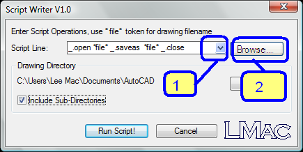

I decided to update my old 'script writer' code to make the program a lot more user friendly.
I realise there is ScriptPro, and I'm obviously not in that league, but this offers an alternative.
For those of you who already write their own scripts, this should be quite easy to manipulate.
The user should enter the script line in the space provided at the top of the dialog, using the *file* token in place of the drawing filename.
Subsequently, the user selects a directory (and subdirectories) of drawings to process, and the script is run.
In this way, the user only has to enter the first line of the script, and not worry about typing all the DWG filenames to be processed.
Comments/suggestions are welcome, and if you get stuck with it, let me know.

There are suggestions
See attached
1- To save the used scripts avoiding rewrite the script each time
2- To locate en existing script and read
3- Adding Help button to explain how to write commands in script line and deference between OPEN and _.OPEN (for example) and what we should observe in writing commands.
Thanks for reading these unreasonable suggestions
HasanCAD
Don't worry, they are not unreasonable - I actually had a few of those ideas in the pipeline :)
Certainly the idea of saving/loading previous script strings - I agree that a help button would be useful in this case, as this program is not as intuitive to use as some of my previous submissions.
Thanks for the feedback,
Lee
I have updated the first post to Version 1.1, in this version the user can:
  • Insert the filename token quickly by pressing the 'Filename' button.
  • Instantly clear the Script line by pressing the 'Clear' button.
  • Load/Save Script Strings for use between sessions.
Enjoy!
Lee

As far as I know, standard DCL doesn't support the combined edit_box / popup_list as you suggest in an earlier post, so I settled with a list_box to display Scripts to load.
