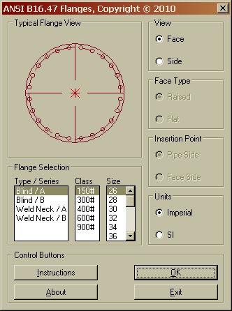

Here is another entmake program that creates ANSI B16.47 Flanges fast. A portion of this program was from Afralisp and modified with better error trapping and external data entries. Thanks to Lee on that as well as the list boxes. This program also has built-in instructions. The program will allow you to switch insertion point locations to install the flanges either to a pipe or flanges face to face without additional maneuvering. The program has a provision to insert the flange in SI units. Layer names, colors, line type and line weight can be edited to suit your standard. Flange Range: 26" thru 60".
This program requires the following files below to work properly.
Make sure to have these files together in the same directory.
Also make sure the the directory is in the AutoCAD Support File Search Path.
This program has a built-in ALERT to let you know if a DIM file is missing. (See Image Below)

I can not use, position in file c:, then "load application" and write AF1 and AF2 in the command line, and I do not see anything, I get the following error
Command: af1
** DCL ** File not Found
What am I doing wrong?
I have autocad 2008
