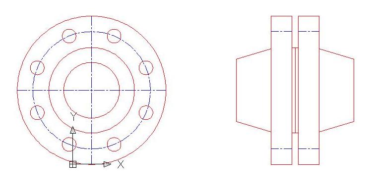

Here is another entmake program that creates ANSI B16.5 Flanges fast. A portion of this program was from Afralisp and modified with better error trapping and external data entries. Thanks to Lee on that as well as the list boxes. This program also has built-in instructions. The program will allow you to switch insertion point locations to install the flanges either to a pipe or flanges face to face without additional maneuvering. The program has a provision to insert the flange in SI units. Layer names, colors, line type and line weight can be edited to suit your standard. Flange range: 1/2" thru 24".
This program requires the following files below to work properly.
Make sure to have these files together in the same directory.
Also make sure the the directory is in the AutoCAD Support File Search Path.
This program has a built-in ALERT to let you know if a DIM file is missing. (See Image Below)

Question, is the side image for WN supposed to be different than the SO, SW & TH?
The images are just shown as a typical face or side image. As you know the actual flanges have different hole qty, sizes, etc etc. So a typical image just representing face and side are used and then I will either show or not show the raised face depending on the selection. If you go to the end of the lisp you will notice a function with many numbers for vector image. The more detailed you get the more numbers you end up with and thus a very large program. In the arrangement of these images you can show a portion thats common in all the flanges then add or subtract from the image what may be different.
I use an external lisp routine to create these lists that you see and program them in a way to show as much detail as needed without going overboard.
