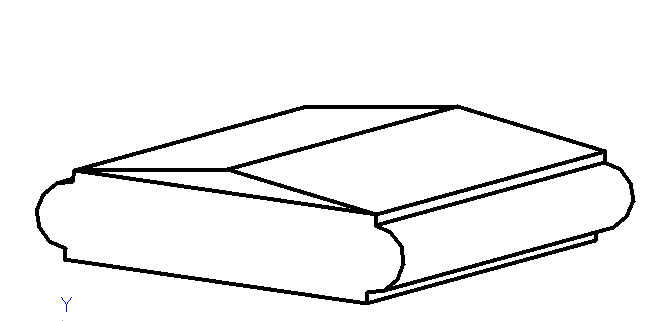

How would I taper this object..
so that it looks like this
Can you use slice>subtract for that? If so, how, I couldn't get it to work.
Yeah, you could use slice, however, it's probably easier just to extrude the rectangle with the taper option and do it in a single operation.
KC
I did it (the sloped top) in four steps using Loft. I created a triangle. Rotated it 15 deg. Mirrored it. Then executed the Loft command.
Other commands used were Pline, line (for reference), and copy.

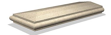

They need that "bead" (the curved bit) to go around the edge and end of the molding... here's my proposed solution: (if someone could illustrate the steps, or otherwise make it clearer, it would be appreciated.. I'm still out of the country at the moment)
View the model from the top and set the UCS to match it. (ie- the top of the handrail, not the end profile)
Draw a line starting from the endpoint on the lower edge of the handrail, ending at @2
Copy that new line, from 0,0,0 to 0,0,2
Change the view to look at it from an angle (ensuring your UCS doesn't move).
Slice the handrail, using two points anywhere on that lower line, and one point anywhere on the new upper line. Press B to keep both halves.
Mirror those lines you drew, and do the slice command again the other direction this time.
Then Erase the unwanted "chunk" at the end of the handrail (the one with the flat bit you don't want).
Then copy one of the resulting pie-slices, and rotate it -90 degrees. Using the endpoint at the top of the profile on that pie-slice, move it to the gap you made in the end of the handrail.
For good luck (and use later) make a copy that pie slice off to the side somewhere.
Use the union command to reconnect all the touching pieces of handrail.. leaving off that little extra good luck piece you put off to the side somewhere.
DO NOT UNION the 45 degree turn in the handrail you modelled earlier with that extruded path thing, unless you use that same sort of directionless pattern you've got shown in your image. Otherwise, woodgrain patterns and stuff will look weird... the texture you add to it will not turn a corner unless you texture it seperately. If it's already unioned.. you'll need to use the slice command on it to seperate it again.. (or use that directionless pattern on it).
To get that stone look, you'll need to look at rendering materials, and select an appropriate one.. or find an image of the surface you want to put on it.

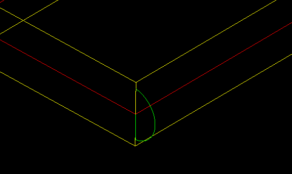

I've got the lines drawn where I would like to remove the wedge off the end. What should I do next?
I'd say slice the sloped top clean off and do it over again.
Slice it using any points along those three lines. (Maximum of two points per line, so slice can tell where the slice needs to be).

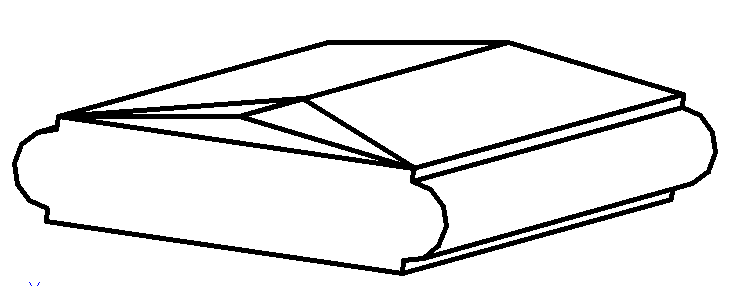

Isn't this trivial? Left to right:
1. rectangle and circle profiles of geometry
2. presspull above path and below path
3. sweep path
4. line, line, line rotate, rotate, rotate
5. presspull
6. extrude, extrude, extrude
7. slice, slice, slice
Example.zipFetching info...
and missing steps
8. union
9. apply material(s)
(I used lines then extruded as surfaces because that is how I think of setting it up in the machine to cut in the real world - no calculations needed). (I made up dimensions and angles.)
