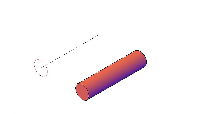

ReMark Posted May 26, 2010 Posted May 26, 2010 In addition to Extrude there is also Press/Pull and Sweep not to mention the use of Polysolid. A path can be something as simple as a line. A circle...well that needs no explanation. Knowing how to reorient the UCS is of prime importance when working in 3D. If you draw the circle at the end of the line, in the proper orientation to the line, then invoke the Extrude command simply follow the prompts after that. Quote
ReMark Posted May 26, 2010 Posted May 26, 2010 Example of Extrude command using Path option. Circle (red) and our path (line in black) on left. Result in red on right. Quote

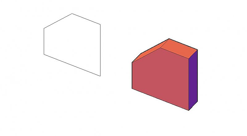

Mason Dixon Posted May 27, 2010 Author Posted May 27, 2010 Its a profile typically used in handrail type stuff. I guess all I need to know is, say I extruded a rectangle a couple feet, how would I take a wedge off the end so that the extruded rectangle tapered at the end? Quote
ReMark Posted May 27, 2010 Posted May 27, 2010 I'd draw the rectangle from the side that shows the angled end and then either extrude it or use press/pull. Quote

ReMark Posted May 27, 2010 Posted May 27, 2010 Here you go. Wall in 2D on left (black). Wall in 3D on right (red). I turned it a bit so you get a better view. 2D drawn using lines. Wall converted into a solid using press/pull. It helps to know how to manipulate the UCS. Quote
Mason Dixon Posted May 27, 2010 Author Posted May 27, 2010 That is what I'm trying to replicate, so I don't think I can draw the side and extrude. Quote
