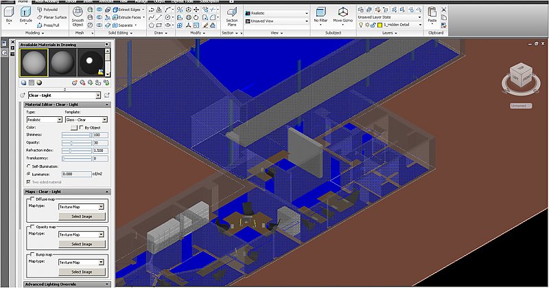

You could you the realistic and give the walls a glass material which will make them transparent

I am not the best with materials as I don't use them, but all I did was to attach the standard clear glass material that comes with cad to the walls
you may have to change the Opacity & Translucency to what you want.
Here is a simple example
