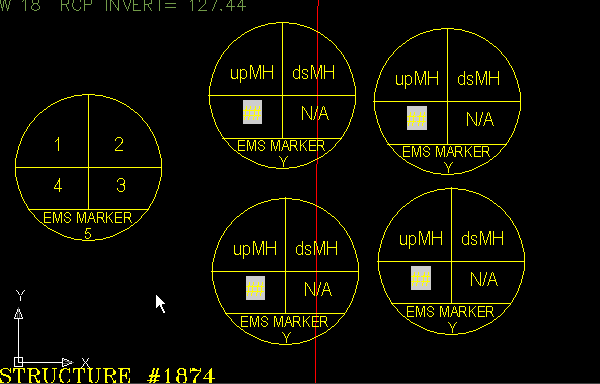

DNK Posted May 25, 2010 Posted May 25, 2010 Anyone have something, or could point me to something that will copy all attribute values from one block to another, keeping in mind that the tags are the same? I have the Dotsoft ToolPac which will copy selected attributes, but I need to copy ALL attributes, whether invisible or on a layer that is off/frozen, without having to select them individually. Ideally, I'd like to select the source block, then then destination block. Anyone? Thanks. Quote

alanjt Posted May 25, 2010 Posted May 25, 2010 (edited) (defun c:MAV (/ AT:GetSel obj ss u aLst lkLst) ;; Match Attribute Values (including objects on locked layers) ;; Alan J. Thompson, 05.25.10 (vl-load-com) (defun AT:GetSel (meth msg fnc / ent) ;; meth - selection method (entsel, nentsel, nentselp) ;; msg - message to display (nil for default) ;; fnc - optional function to apply to selected object ;; Ex: (AT:GetSel entsel "\nSelect arc: " (lambda (x) (eq (cdr (assoc 0 (entget (car x)))) "ARC"))) ;; Alan J. Thompson, 05.25.10 (setvar 'ERRNO 0) (while (progn (setq ent (meth (cond (msg) ("\nSelect object: ") ) ) ) (cond ((eq (getvar 'ERRNO) 7) (princ "\nMissed, try again.")) ((eq (type (car ent)) 'ENAME) (if (and fnc (not (fnc ent))) (princ "\nInvalid object!") ) ) ) ) ) ent ) (if (and (setq obj (car (AT:Getsel entsel "\nSelect Attributed Block: " (lambda (x / e) (and (eq "INSERT" (cdr (assoc 0 (setq e (entget (car x)))))) (eq 1 (cdr (assoc 66 e))) ) ) ) ) ) (not (initget 0 "Yes No")) (setq *MAV:Choice* (cond ((getkword (strcat "\nMatch ONLY selected block \"" (vla-get-name (setq obj (vlax-ename->vla-object obj))) "\" [Yes/No] <" (cond (*MAV:Choice*) ((setq *MAV:Choice* "Yes")) ) ">: " ) ) ) (*MAV:Choice*) ) ) (setq ss (ssget (list '(0 . "INSERT") '(66 . 1) (cons 2 (if (eq "Yes" *MAV:Choice*) (vla-get-name obj) "*" ) ) ) ) ) ) (progn (setq u (not (vla-startundomark (cond (*AcadDoc*) ((setq *AcadDoc* (vla-get-activedocument (vlax-get-acad-object)))) ) ) ) ) (vlax-for la (vla-get-layers *AcadDoc*) (and (eq :vlax-true (vla-get-lock la)) (setq lkLst (cons la lkLst)) (vla-put-lock la :vlax-false) ) ) (foreach a (vlax-invoke obj 'GetAttributes) (setq aLst (cons (cons (vla-get-tagstring a) (vla-get-textstring a)) aLst)) ) (vlax-for x (setq ss (vla-get-activeselectionset *AcadDoc*)) (foreach a (vlax-invoke x 'GetAttributes) (if (setq att (cdr (assoc (vla-get-tagstring a) aLst))) (vla-put-textstring a att) ) ) ) (vla-delete ss) (and lkLst (foreach l lkLst (vla-put-lock l :vlax-true))) (and u (vla-endundomark *AcadDoc*)) ) ) (princ) ) Edited March 2, 2011 by alanjt 1 Quote

DNK Posted May 25, 2010 Author Posted May 25, 2010 CLIPPED [ATTACH]20234[/ATTACH] Thank you. Works as described. Quote
DNK Posted May 25, 2010 Author Posted May 25, 2010 You're welcome. Just discovered that it'll only work if the block name is the same. Right? Can you make the block name not matter but still match values of the attributes as long as the tags are the same? Quote
Lee Mac Posted May 25, 2010 Posted May 25, 2010 Just remove this part from the ssget filter (cons 2 (vla-get-name obj)) Quote
DNK Posted May 25, 2010 Author Posted May 25, 2010 Just remove this part from the ssget filter (cons 2 (vla-get-name obj)) Thanks. Quote
