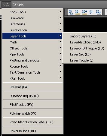

alanjt Posted May 25, 2010 Posted May 25, 2010 I like adding buttons in my cui for my lisp routines, then stick 'em on my toolbars. I'm a keyboard-man, but I do have this pulldown that loads with our company CUI... I'm not about to make button images for all this crap. Quote

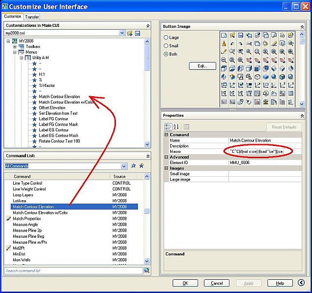

mvrcad Posted May 26, 2010 Posted May 26, 2010 guys i want to do the same thing, but am having trouble following this, i cant see instructions on how to place a lisp routine into a pulldown or toolbar. Quote
lpseifert Posted May 26, 2010 Posted May 26, 2010 In the CUI create a new Command using a macro as shown in post #3; drag it to the appropriate Menu or Toolbar Quote
