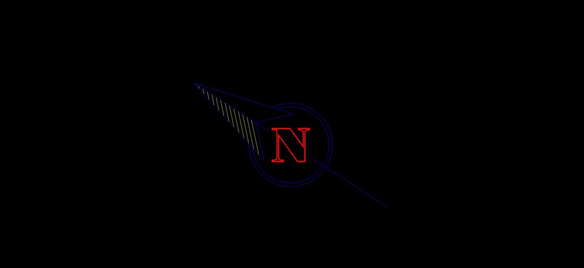

I ended up starting from scratch with new geometry, and got it to work. Unfortunately, because my geometry and my letter have different base points, it's a little weird, and I'm going to have to play with it... but I understand the premise now!
Since the North arrow would be case sensitive based on the sheet configuration, viewport placement, etc... (in paper space) there are other options.
A viewport within a viewport would work fine.
One with the N text (perhaps a circle) within a larger circle containing the north arrow.  It would stay in model space - so if you rotate the viewport the North arrow will always be accurate and the N text always true.
The good thing about having circle viewports is they're easy to rotate around the center point without affecting anything..
If you have another rotated viewport, you could easily match the angle by using a reference line or using matchprop command.  There would be some additional steps, but it would work.
Although, an ideal method would be to have a LISP where you could click the viewport and it would insert the north arrow at a matching angle.

Cool that works.
If you want the North arrow to stay static you can apply the ROBLKLAY lisp to just the arrow portion and have the N text stay at zero rotation.
I'm curious if this can be done in one block but I don't think it can.
it might be possible to apply constraints to keep the rotation of the N text at zero but any rotation applied to the parent would rotate everything - even with the constraints applied.
-ChriS
I would have thought the N is always orientated in the direction of the arrow, in a dynamic block maybe rotate 180 so its not up side down.
