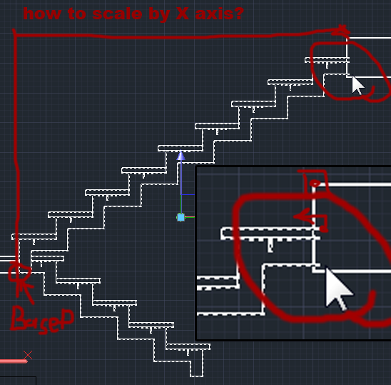

How to scale by X axis?
thank you for answers
Convert to block, adjust the scales on X and Y from the Properties window and finaly explode the block.
well, how to make reference point in this case? ;]
it's kinda hard to calc the X scale facor to strech it just 2cm :]
Edit: answer to my question = (needed length) / (total length)
Thiank you for nice tip, but it could be easyer to strech things in autocad 2D and 3D Lines :]
*Bump* Strange happens, when I explode block, lines dissapear. Why?
