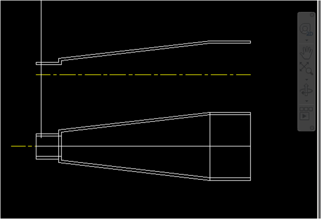

I now have a new problem I would like some help on if possible. I’m now trying to draw a spout to fix onto my watering can but I’m not sure which is the best way to start drawing it (see images below).
The dimensions are shown in image no. 1 below and then it should look like image no. 3 (bottom) when complete.
I can easily use the extrude command to extrude the circles out to the required distances but how would I extrude from a 38Ø circle to a 26 Ø circle (see image no. 2 below, highlighted).
Maybe using a Taper Angle command?
Thanks
Bobzy20
Draw one half and Revolve. Do not need to know the angle. I would do one half solid revolve, then shell and finally chamfer.
i WOULD DRAW THE ONE PROFILE OF 2 THICKNESS AND THE REVOLVE IT AROUND THE AXIS AND THEN YOU WOULDN'T NEED TO SHELL IT AFTER

Cheers for that guys, all sorted now.
Cheers for the example SPARKY77 :)

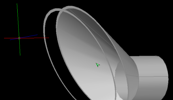

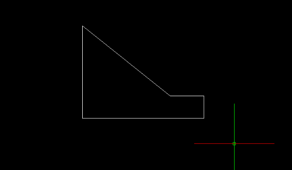

Ok now I’m trying to create the Sprinkler Head but again I’m not sure how to turn it into a 3D Solid. I’ve drawn the profile as per the illustration below but how would how do I turn that into a solid, Revolve or something else?
Also how would you go about creating those small ø2 holes equally-spaced at 4mm centres about the centre of the face? I guess using the array command?
Again any help would be great.
Thanks
Bobzy20
Revolve won't work. I'd consider Loft.
I have to disagree with you Remark you could use Revolve. You would create a funnel and then subtract the 40deg angle and fillet the edge with a radius 5. Then shell the object and then create the holes on the surfice.
Here's an example
Very good point Sparky. To tell you the truth I hadn't thought of that. Nice catch. :)

I would take a slightly different approach but their are many way's to do it...
Revolving a simple profile is a good start and will get you a basic cone to work with.
Then you can shell the solid for your wall thickness and create a slicing plane at the appropriate angle
Now slice and separate.
Now use Copy Faces to get your spouts surface for the holes. (remember to explode the copied surface to get an extrudable profile).
And extrude it out the thickness you want...
Now you have a solid ellipse to work with... After making the holes you can union the two and fillet or just keep them separate.
Good Luck.
Here's an example
Shell feature - sounds good!
I have got it but I think it is at home so I will post it later.
Here is the profiles I used to create the nozzle and the steps I did to get the final nozzle shape
