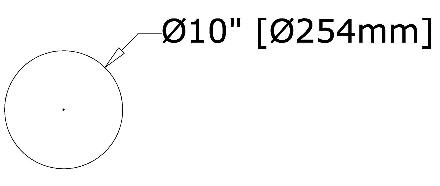

Chiefsmack Posted May 20, 2010 Posted May 20, 2010 This is probably an easy answer but I can't figure it out... What i'm doing is regenerating an existing hard copy of a drawing to get some parts water cut... The drawing dimensions are in millimeters... What I've done in the past when doing similar projects is converted the dimensions to inches as I went... What i'm curious to know is there any way to draw the part in metric units and dimension it in inches?? Any answers are greatly appreciated! Thanks, Chief Quote
Glen Smith Posted May 20, 2010 Posted May 20, 2010 The simplest thing to do is use a dimstyle with an alternate unit attached. Make sure that Format - Units is set to inches as it is in the attached drawing and use the dimstyle defined in the drawing. Glen Facepalm - except you want to go the other way. I don't have that one set up, but you should be able to figure it out. Go to Format Dimension styles and look at what is in the inches [mm] dimstyle, then create a mm [inches] one from that. atlernate dims.dwgFetching info... Quote

Chiefsmack Posted May 20, 2010 Author Posted May 20, 2010 Thanks Glen... I understand what you've done in the attached drawing which in most cases would work great... I had actually considered doing that but then I realized I can't... I probably should've stated this in my first post but here's the thing... When I draw something to get flame or water cut I save it is a DXF file with no dimensions on it except for the thickness of the Matr'l... When our vendor opens the file they simply import my DXF into whatever software they use to create their geometry to cut the parts out... The problem is that their units are set to inches just as mine are in AutoCad so if I would draw say a 50mm line at 50 units when they get the file that line would be 50 inches... The more I think about it the more I realize that there's probably no way to do what i'm trying to... I'm sure that the vendor could set his software units to millimeters but this would most likely complicate matters... It's really not a big deal it would just save me some time and I guess curiosity got the best of me ... Thanks for your help! Chief Quote
