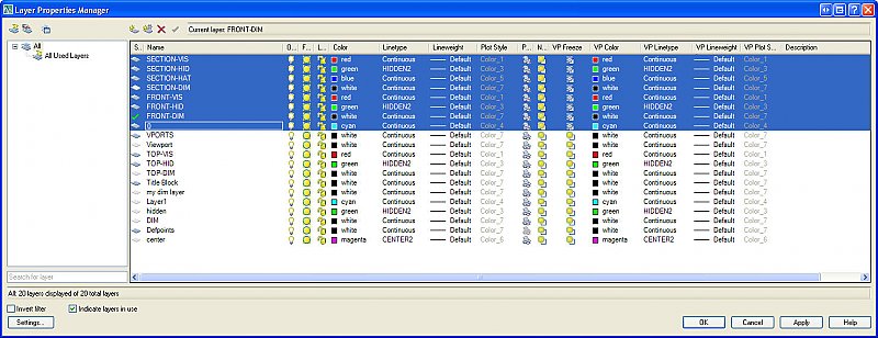

It should copy the vieports, too - please check the status of your layers.
Regards,
Regards,
I confirmed Layers of Front view and side view are ON. Is there anything else, I am missing?

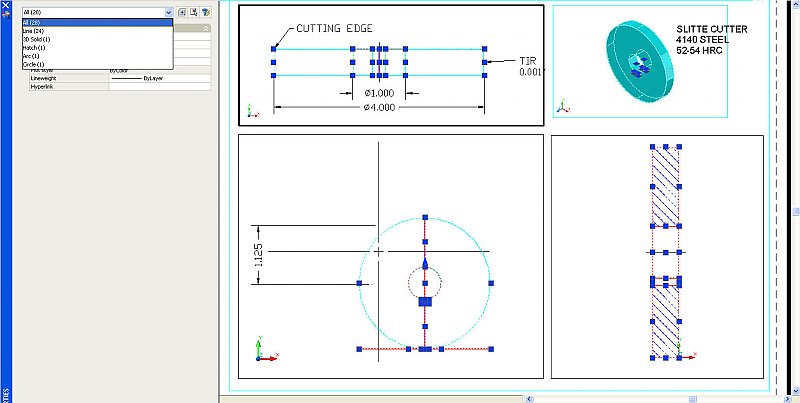

I think it's your understanding, rather, misunderstanding of the relationship between paper space and model space.
Paper space provides the ability to create windows (viewports) to see the drawn elements in model space. It allows for multiple views of the same object in model space. It's not images of the object, it is the object.
Well, In the attached drawing, Model space Object is 3D-Solid, wheres in paper space objects (front , side and top view) are lines and circles. and same lines and circles are showed up on Model space, whick looks clutter.
It does not happen in ProE or even in solid works.
