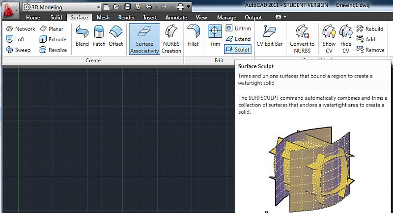

... it doesn’t have the ability to stitch together individual surfaces...
Not needed in 2011. Sculpt command will "flood fill" enclosed volumes.
That’s good to know. I may even get a chance to give it a try in the semi-near future . . . . if all the budgeting efforts pan out. Have you been able to determine if it is significantly more competent than the geometry illustrated in that help blurb?
With regard to the “... it doesn’t have the ability to stitch together individual surfaces...” statement; that definitely applies to AutoCAD 2007 (OP’s version).
