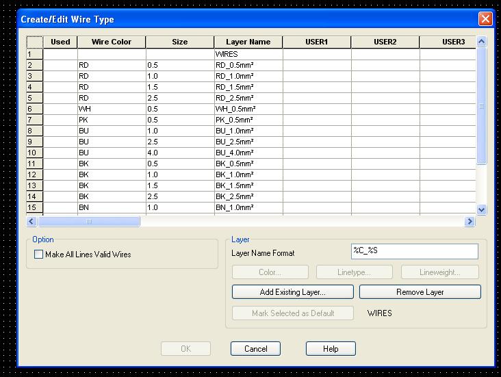

I'm at home now so I'll ry to write something with ACADE in front of me tomorrow. You need to add wire layers through one of the "wizards" rather than the layers manager. I have decided to add the layer name to the wire number so I spent a bit of time setting up the layer names. I have 4 red layers for my +24v power (4 different wire gauges), 4 black layers for my 0v (4 different etc. The layers get named by default with colour and gauge and I am debating leaving in the underscore or replacing them with spaces. I think I will let ACADE do its own thing most of the time though.

new wire layers are added through the wires|Create/Edit Wire Type menu or palette or through the wiretypesel command. This will get you a dialogue box. (picture attached?) The %C_%S default automatically gives you the colour_size layer name but I have added the ^2 manually.

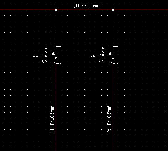

As we won't be using wire numbers in the way ACADE wants us to I have the layer name added to my automatic wire numbering with the results shown in the other attachment.
